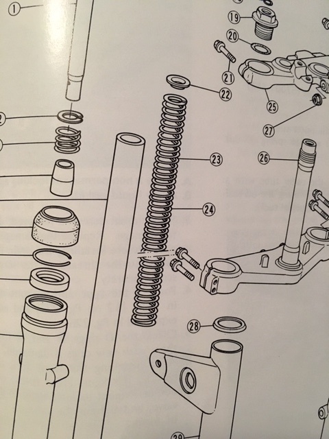

There doesn't seem to be any hard and fast rules concerning which way the fork springs are put into forks. I would be just consistent on both sides. This screen shot from the manual appears to have the tighter wind at the top.

If the goal is to minimize 'un-sprung weight', then it would make sense that the tighter coils should be at the top. I've always done it that way but is seems to me that Progressive brand springs suggests it doesn't matter.
