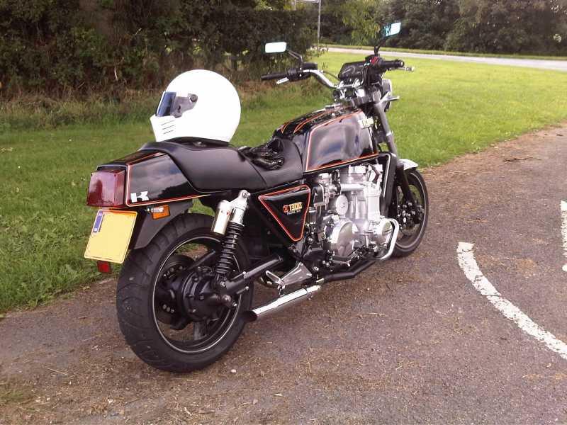

I fitted ZRX1200R rear shocks to my own current bike.
I owned a ZRX a couple of years ago & was very happy with how it handled at the front & rear end so chose these shocks as a result. They are very good in general with 1 or 2 people ontop.
They are a little longer than the standard Z1300 (pen spring) type but still look great.
My swinging arm is a one off made to accept a VMAX diff unit, to enable me to fit a wider 3 spoke rear wheel, so I have extended the top frame mounts out to match, but i THINK these would bolt straight onto a standard set up.
Hope that helps ?
Hope that helps ?
Pete F
UK

Hi Pete
Thanks very much for the info I will certainly use that as food for thought !
Great bike by the way Love the wheels and Vmax diff idea more food for thought!
Cheers
Chad
