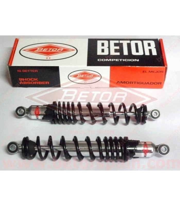

Once I solve the engine part, if I ever do, I will have to adjust the shock absorbers, Christine behaves like a merry-go-round horse.
I was planning to buy this pair of Betor shock absorbers, the store where they are sold is just 8 km away. from my house.
BETOR SHOCKS
BETOR SHOCKS

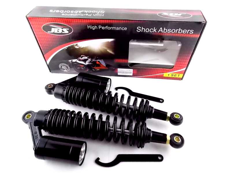

I did read your write up in the Tech Forum about fixing these shocks -- good job. I bought a pair of non-piggyback JBS rear shocks for my little Z250A a few years ago and they were 'orrible! I'm sure the Ikon tri-rates will be fine.
