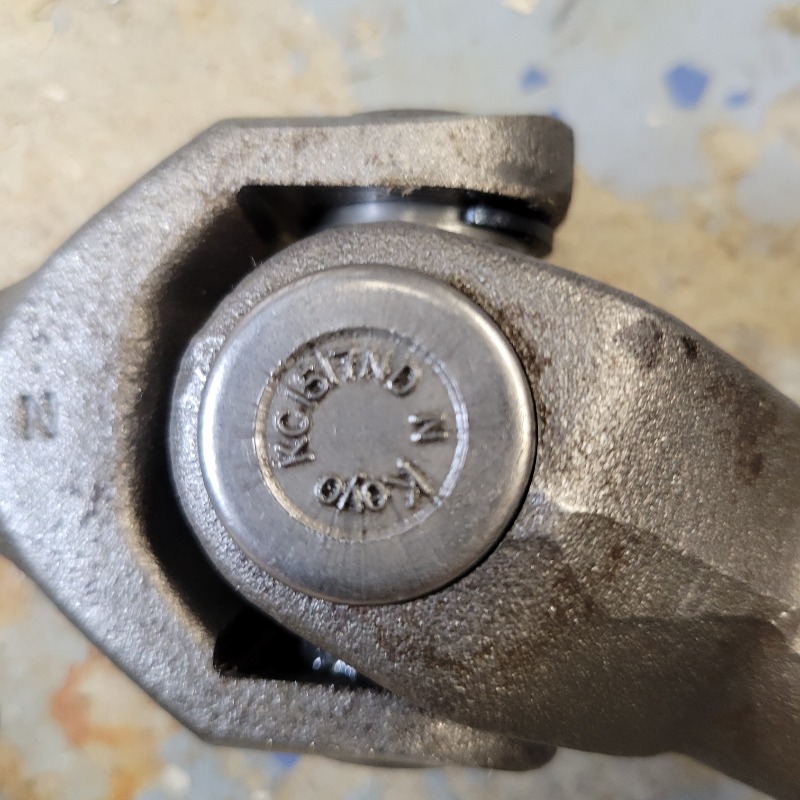

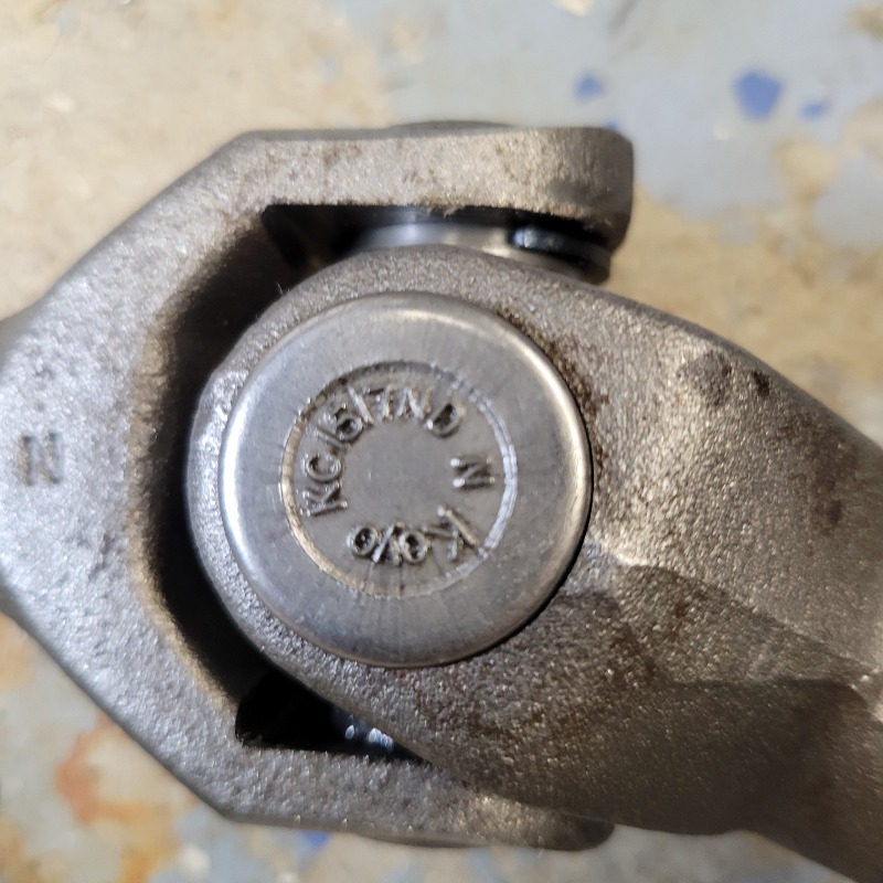

Photo of the bearing cup with the Koyo part # KC1517ND. 25mm bearing cups and 63mm outside measurement. There are a lot of suppliers with 25 x 63.8mm uni joints and only an Alibaba listing for the 25 x 63mm as far as I've looked on the internet. I don't need a joint right now so I'm just posting my findings for future reference.

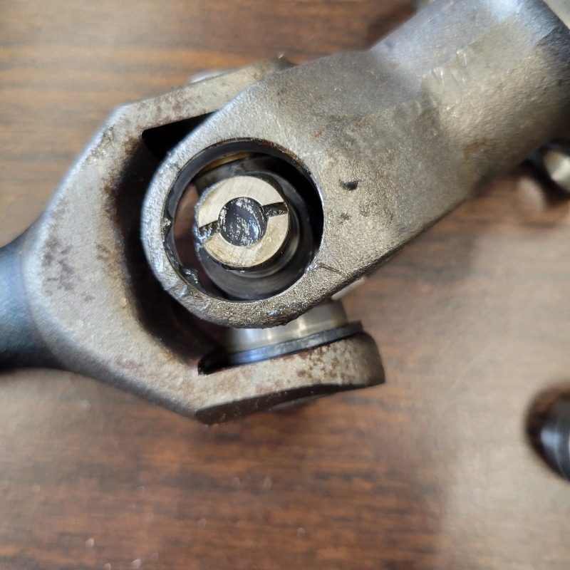

This photo shows the cross drilling of the cross, so it was easy to grease all 4 cups by just popping off one bearing cup.

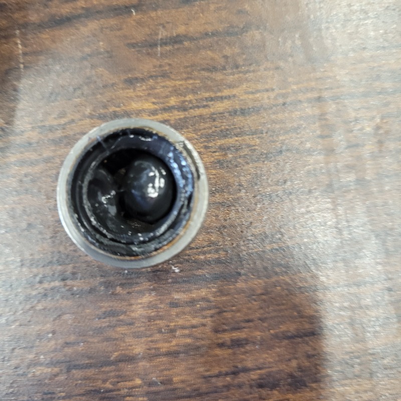

Each bearing cup has a lip seal ( interesting) I used the grease gun and pumped the cross then added some grease to the last cup and tried to install. Too much grease in the last cup and it was hydro locked when trying to install. I had to remove some of the grease in order to seat the bearing cup.

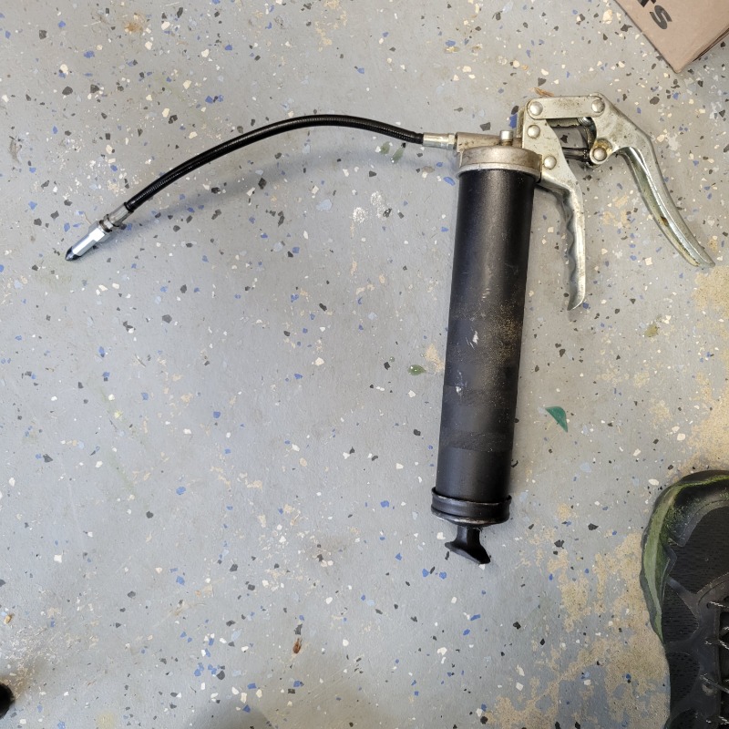

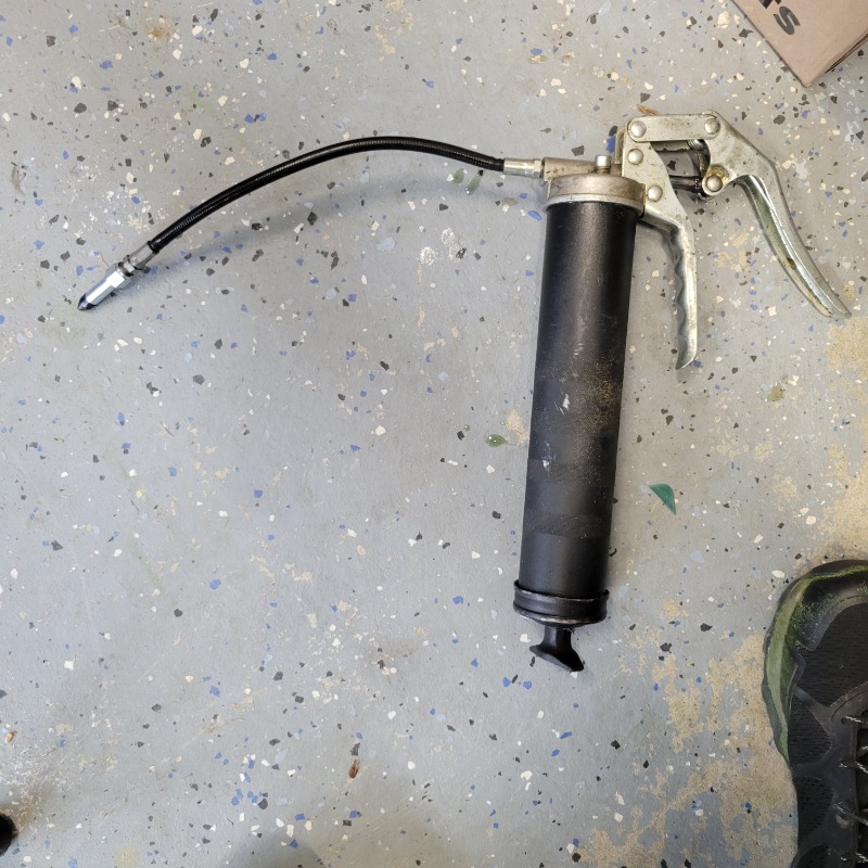

I found this rubber tipped grease gun fitting at Canadian Tire for $4.99 and fitted it on the grease gun. Worked a treat.
