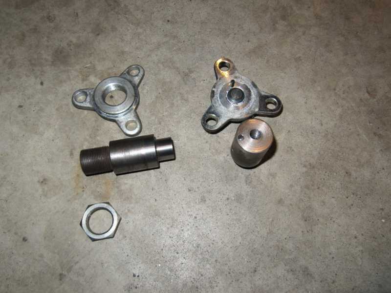

Here are the two pins compared, shown right is the more common type with indexing pin, and left is the threaded type.
I think I will use the type on the left when I put it back together, unless anyone knows why that design was changed... or any reason not to?

I noticed the same thing myself a while back while swapping parts from another A1.I noticed a few changes besides the swing arm pivot points.Also the front fork pinch bolts are different and the some of the electrical connectors are different as well.Maybe they switched suppliers?Or the change in design was superior to the original?I think we will never know unfortunately
Unless you go to Japan and track down the engineers(if still alive) and ask them.
