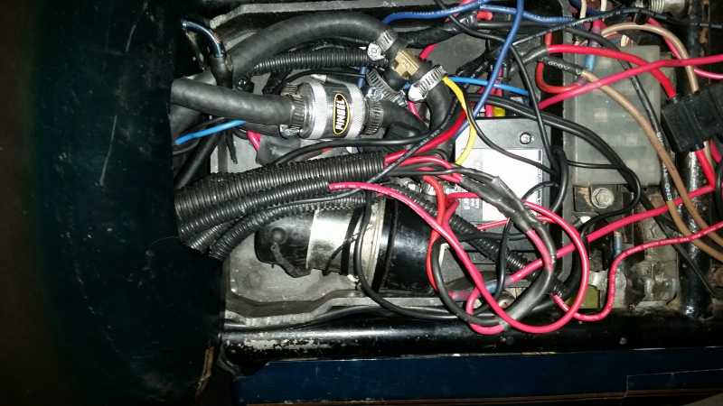

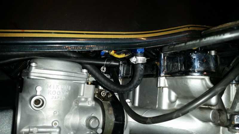

Finally got the fuel pump to work for me. I purchased this FZR1000 fuel pump last year and when I initially did attempt to install last year the bike would run way too rich and flood out the motor. Some one suggested to install a brass tee and a 6AN bulk head fitting to the bottom of the tank and it works. The pump has resolved the vapor lock, starvation and makes it a lot easier to start. My only concern is that this pump wasn't really designed to run continuously I believe. It gets pretty HOT. I may switch to a NOS low pressure fuel pump to be on the safe side. It's Murphy s law with me. I have a feeling this pump if it does fail will happen at the most in opportune moment like a 18 wheeler barreling up my ass and need to accelerate rapidly to avoid getting squashed

Your right it can flood the motor that's why you need a return line to the fuel tank to relieve pressure.If not you will have the issues mentioned.
