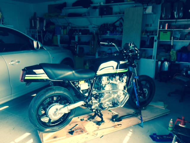

10 years 9 months ago - 10 years 9 months agoHelp i have now been trying to get my bike A! with A3 engine and the dodgy ignition everyone seems to hate running for 8 months had her running last week but the guy seems to think a wire shorted and may have damaged a transistor which is being replaced he also changed some wiring to the coils very frustrated and i am going to remove the bike from this guy being a carpenter builder electrics etc are not my forte but i am going to have find someone who is and really feel like i need to start again not bothered about expense really just want her running these are very complicated bikes i have just done a Z1B which i plugged together away she went so all said what i need is a list of where i get some one who knows what they are doing and ask them to go through the following checks which i would be grateful if someone could supply where i would start after 8 months going insane even starting to think the guy wants to tire me out with it so i say mate I'm over this you can keep it and walk away

My next move was to buy some fuses and plugs yes she turns over and ran a week ago but i am at the mercy of a guy who i am now sure does not know what he is doing i ami not about to stand for this and tomorrow he will be relieved of the project one way or another there will be only one winner there anyway going to get a new set of plugs has it has spent a lot of time turning over and not starting he did say he was tidying up the coils wires and it has not fired since but since my lack of confidence with this guy i really want to go through the whole thing and make sure its all correct
