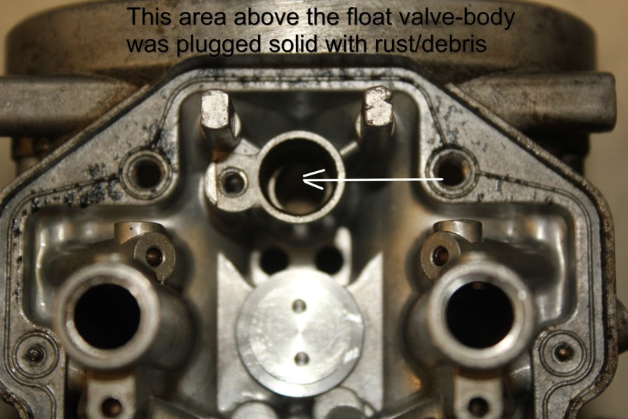

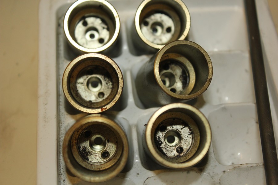

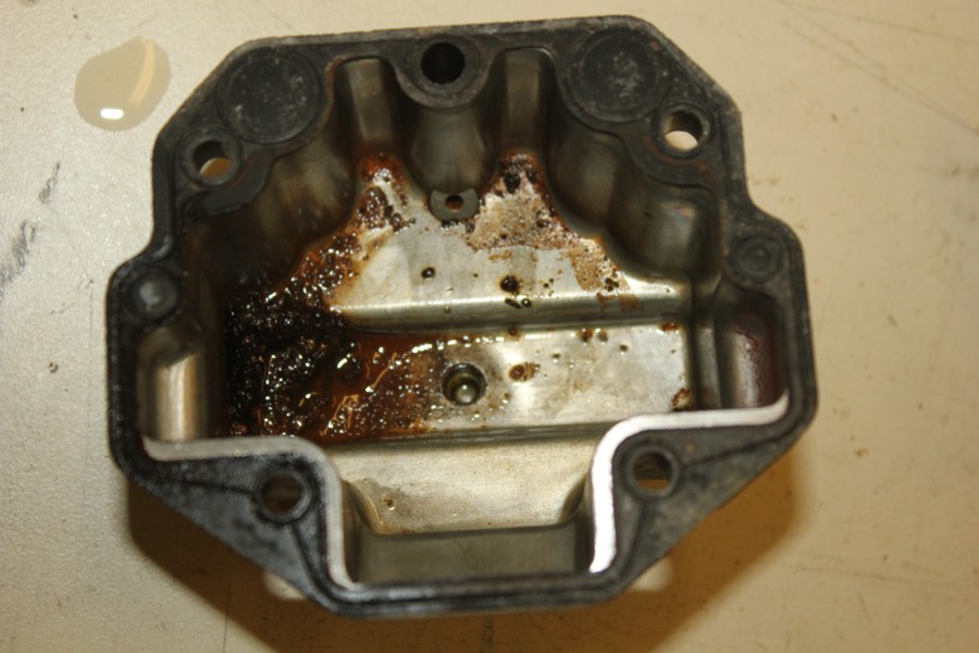

In disassembling another set of carbs I recently purchased I came across something that gives me reason to make a comment regarding your suspicion of fuel starvation. This is not a definitive answer but certainly gives cause for investigation.
First; The float-bowl for the left carb. had a significant amount of rust collected on the left side of the bowl. The center and right carb. bowls did not have this build-up. It would seem apparent that the tank on the former bike had significant rust issues (and no fuel filter) and given that the fuel "tee" is between the Left and Center carbs the build-up in the left bowl is logical. The debris would flow from the tank to the "tee" and given the bike spent time running on the side-stand, the heavy rust sediment would naturally flow down-hill from the "tee" to the left carb. and accumulate in the lower side of that bowl (when on the side-stand). Additionally I discovered a solid "plug" of similar rust debris completely blocking the fuel port immediately above the Float-needle valve-body of the Center carb. This blockage would have rendered this carb. completely incapable of receiving adequate, if any fuel. Having said this, it is possible that enough fuel could seep through the blockage giving enough fuel for idle but certainly not for anything above idle. Unfortunately I had removed this blockage prior to seeing this thread but the explanation should be self explanatory. The photo of the slides shows significant dirt on the inside which is testimony to the fact that the bike had been running with no air-filter or a damaged one. Operating any engine without a good quality air and fuel filter is inexcusable, defies logic and shows either the lack of comprehension for their requirement and/or speaks of someone's desperation in trying to solve an issue in a misguided manner.
Cleanliness, my brothers ! Cleanliness ! If your filters don't capture the crap; Your carbs will !
