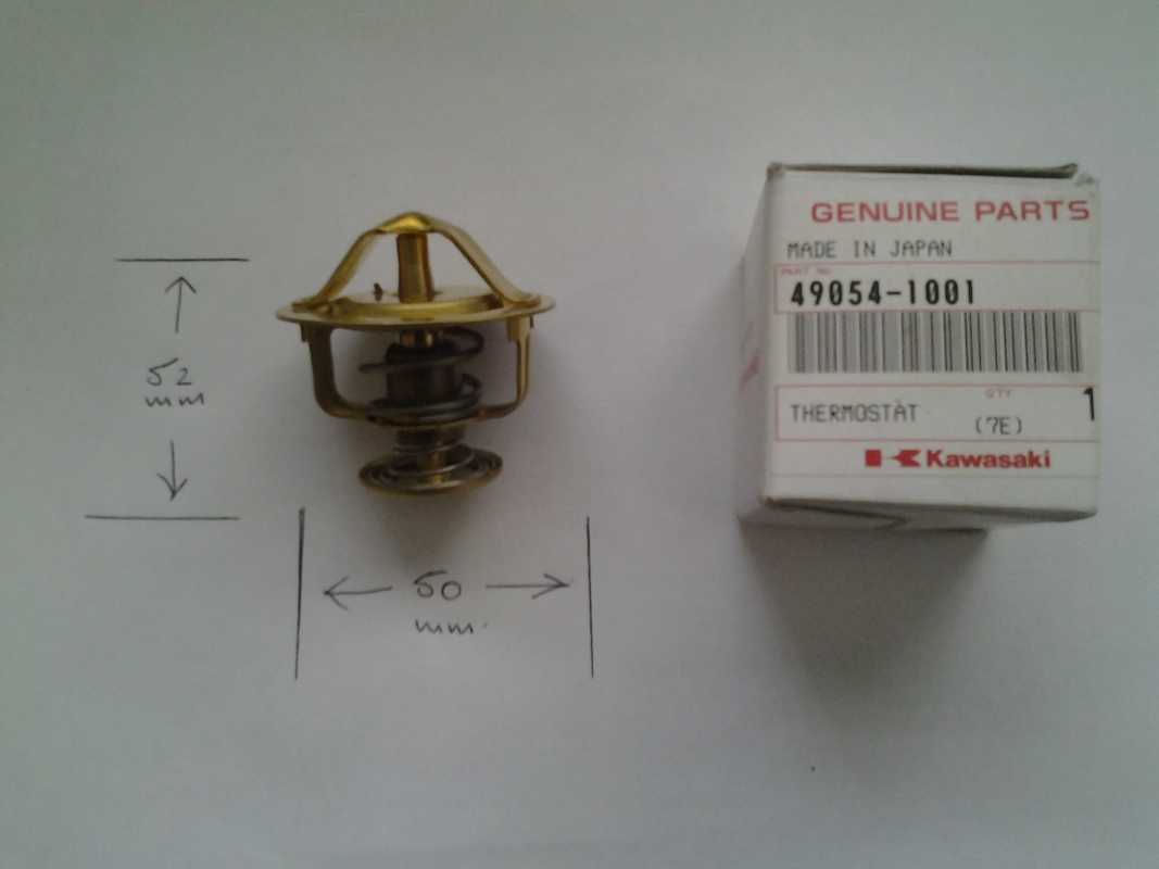

Anyone know the size of the kz1300 series thermostat. Is there a automobile thermostat that would be the same size or compatible?

Hi. Is this any help? Stamped up with NTC 82 c.

NTC 82C - Mitsubishi Eclipse 2006-2009 Thermostat - $18 at Advance Auto parts.
