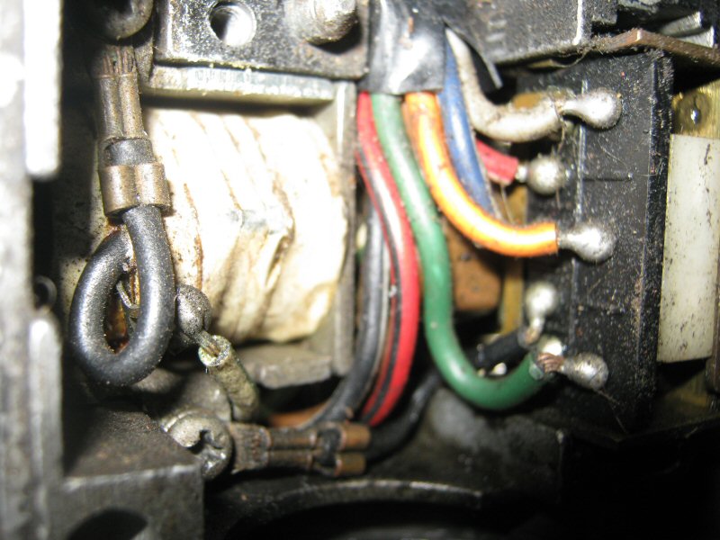

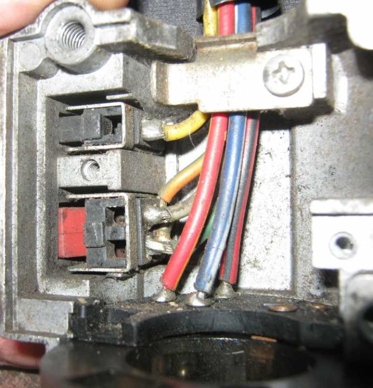

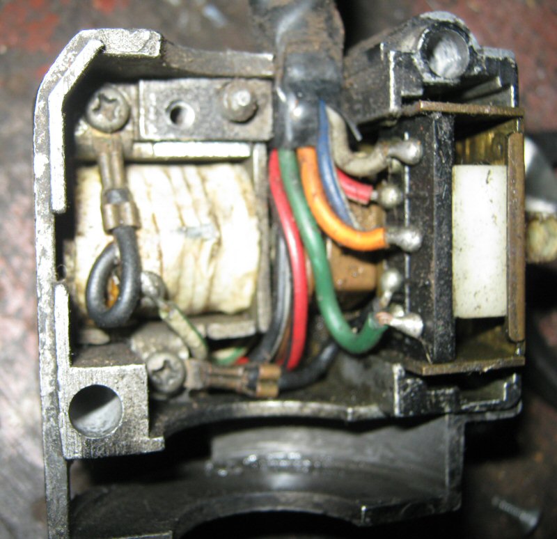

I'm pretty sure the orange wire is soldered in the front middle and the blue/white is soldered in 5he back middle from looking at the wiring diagram. Anyone know for sure?

This is a spare of mine, bit old and dirty ... hope it helps, left hand, high beam switch, blinkers etc

Great photos man. I had to clean the soldering points and resolder my orange wire, blue/white and white/red wires. Fortunately only three wires pulled loose in the switch housing. Thanks for the verification photos.
