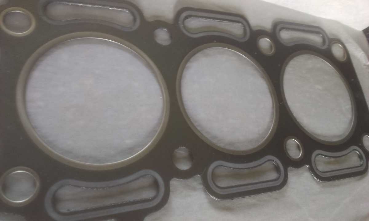

Hi, All
Should be a simple one, I'm using an original kawasaki Head gasket, is it a good idea to also use a sealant, either a sylicone type or a semi hardening one around the coolant passages. Or as it's an original gasket just not nessacery?
Thanks Pete.
Thanks Pete.

That's strange you saying the gaskets would be around 30 years old by now as mine looks like a new product with a bar code etc, I've opened the packet and the gasket feels sticky. Might ask the supplier,

If you are using a Genuine Kawasaki Head Gasket .......DO NOT USE ANYTHING AT ALL WITH IT.
You will see it already has a ring of sealant around the water channel holes. Putting more on can affect it.
As others have said, just make sure both metal surfaces are mega, mega clean and oil free (clean both surfaces with solvent or petrol before putting gasket on).
If you are NOT using a Genuine Gasket............leave all your tools out and check you have recovery insurance !

Seems there are conflicting views on the whole subject. I'm about to do mine, I've got a genuine head gasket to use and an aftermarket which is in the full set I got for the rest of the job.Does anyone know when Kawasaki stopped making head gaskets and is age a known issue, ie if a gasket lasts 30+ yrs in the engine would it degrade on a shelf in a bag? I bought a tube of threebond which I'm now unsure whether to use.
Pete , I am guessing you have fitted a number of genuine gaskets over the years and not used any sealant and never had a failure?
PS just taken both head gaskets out of the bag. The genuine looks like it could have been made yesterday..so thats good. The aftermarket as said has no silicone round the coolant holes and just looks like a poor quality item, so all I suppose is on condition, mine definately looks good to go straight on
