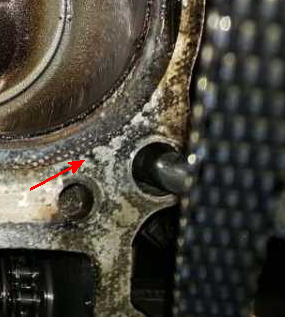

9 years 8 months agoThe red arrows show where the coolant is starting to leak through. It doesn't need much but a bit longer and it would have been oil in the water
The black stuff is coming from the exhaust ports because of the passages that lead to the port for the crazy US polution regs. It's nothing to be concerned about as the reed valves and smog plates aren't there. It should not have any effect on fuel mixture.
Those bores are very shiny I would consider a set of rings and a hone if you can see to it. Not 100% necessary at all but helpful for maintaining optimum performance
