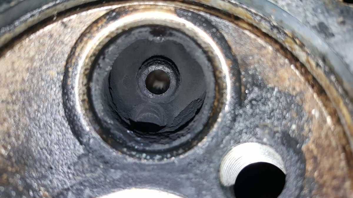

I am running a bit short of time today and would like to get these photos up for people to consider and hopefully comment on. I will post the exhaust cylinders first and post the rest in a following post, so here goes!!

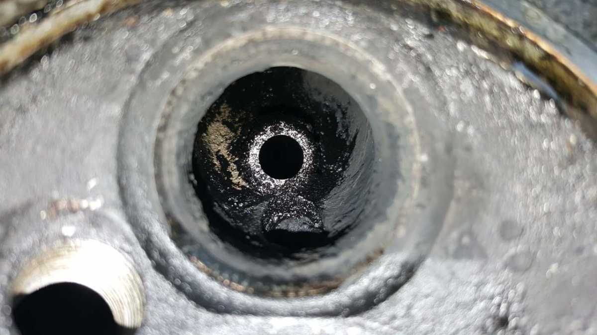

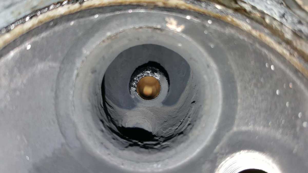

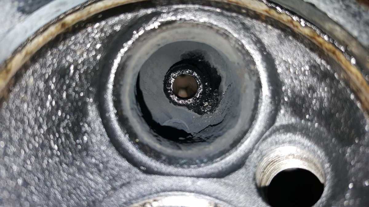

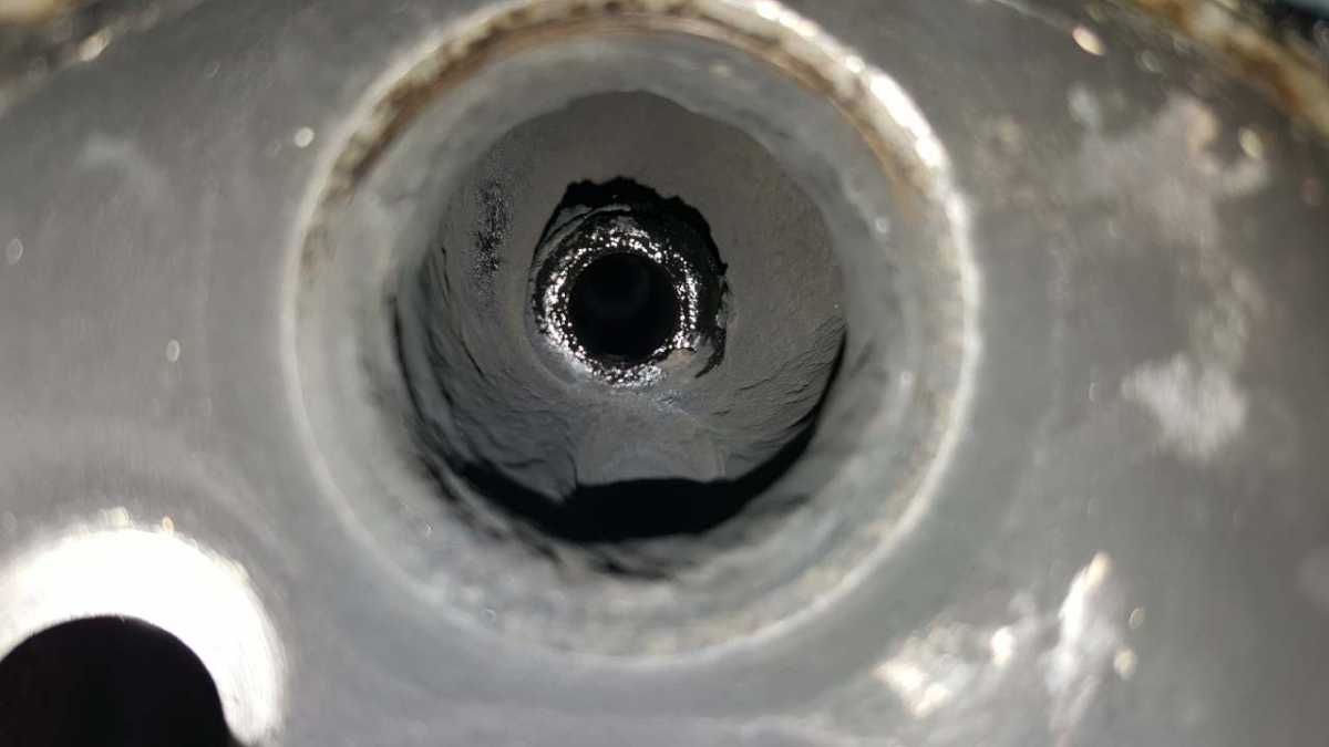

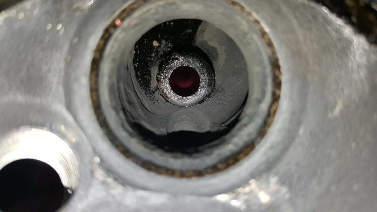

These are the 'journals' I think are clogging up. These journals go up into the cylinder head cover. For those of you with the 'Clean System' and get vented out the top of the cover. In my case it goes nowhere, maybe it recirculates. Two photos one of a journal which is not too bad and the other which looks much narrower due to the build up. Wondering if this is a cause of uneven air fuel mixture??

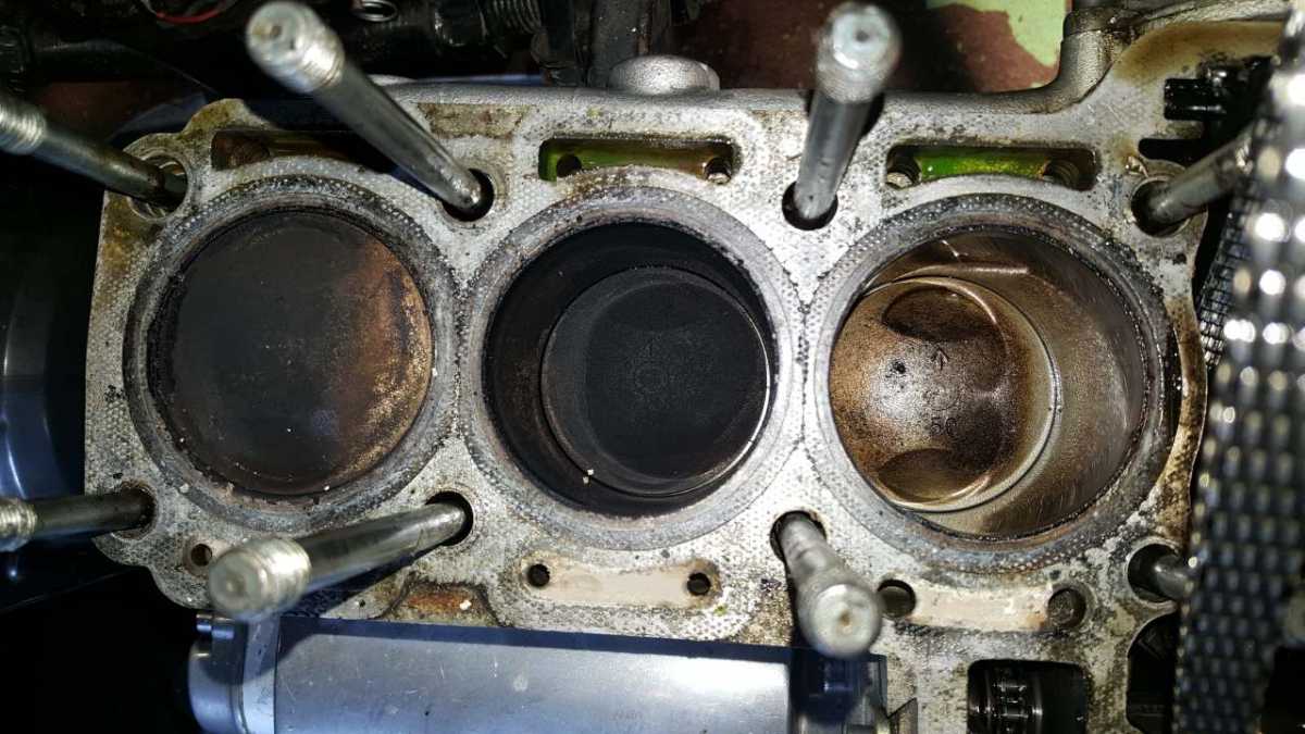

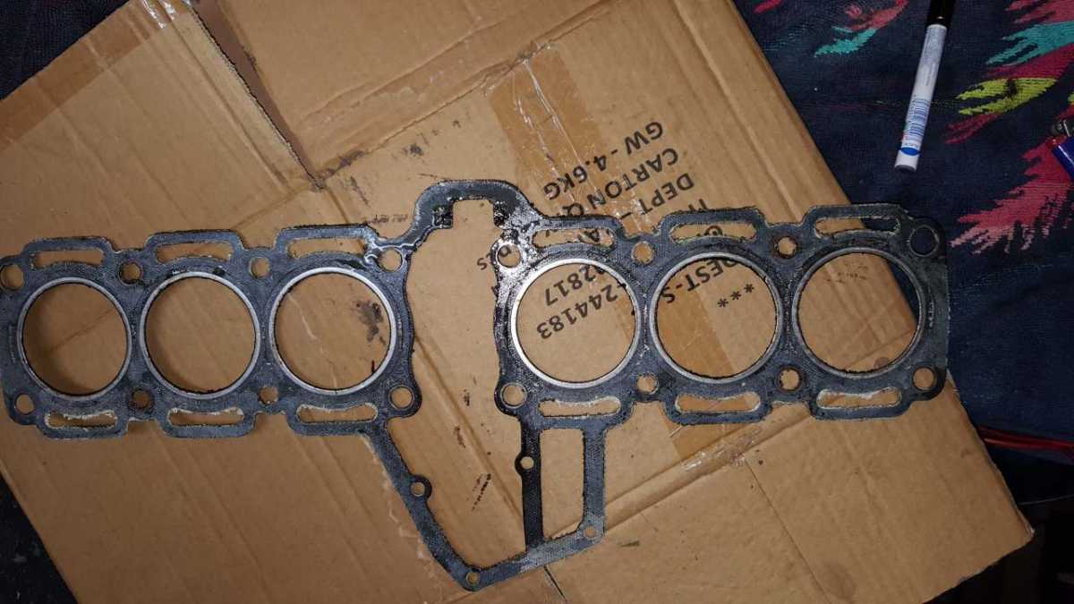

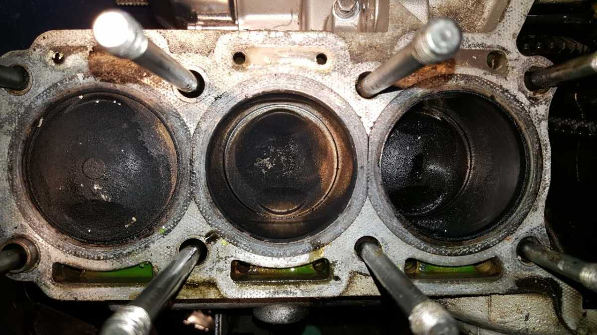

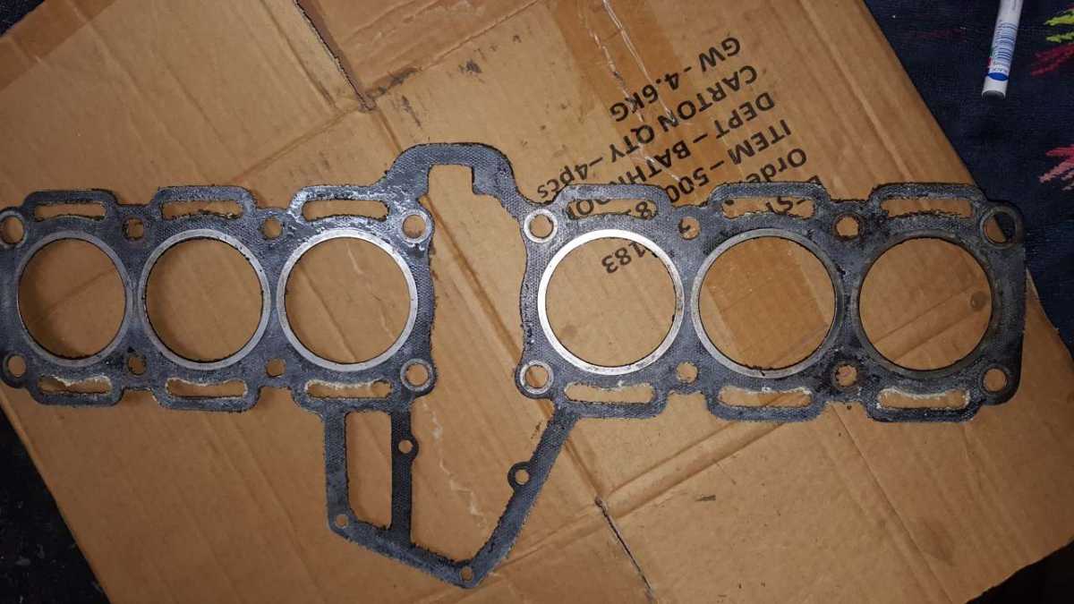

Last time I measured the compression was with the motor hot, this time I measured the compression with the motor virtually cold.
All measured at 150 except for No. 3 which was out of spec at 130psi. I am trying to work out if I have to go deeper into the engine to establish root cause(s).

9 years 8 months agoRickG wrote: The #3 piston being clean usually means coolant is getting in and that is usually the head gasket failing when you get that.
At the 1.45 mark it shows the valve seat of I think #5 and that valve is not seating properly, probably just general wear and tear as the others arent exactly good.
the #5 combustion chamber has quite a lot of soot which means that a rich mix is present.
The seal remnants is most likely the cause of the ticking but I think you probably figured that out.
You ask about the black maybe being a carbon build up, I couldn't get a good look but more likely remains of a head gasket.

9 years 8 months agoYaegunp wrote: I am trying to work out if I have to go deeper into the engine to establish root cause(s).
I don't think there's anything in the bottom end that will need attention for your carbon problem, however, you have disturbed the base gasket now and you should replace that (or else oil leaks will be likely). And anyway, you should clean up those pistons tops while you're here.
