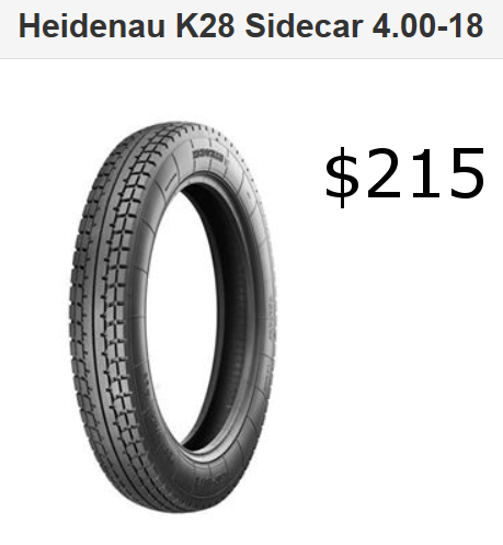

That's very interesting info Pete. So far in my searches I have only come up with an Avon Sidecar 3.50-19 Universal, which won't fit and a Heidenau K28, which may fit but I don't understand the sizing they use (4.00 – 18 M/C 70P TT?). I hadn't come across the Dunlop K70 in my searches and just looked at it now, half the price of the K28 but they are quite different tyres. I forgot to mention Metzler has a Block K sidecar tyre as well for around the same price as the K28.
Presently I am running a Dunlop Arrowmax GT501 (for rear wheel use) on the front and a Bridgestone Spitfire 11R on the rear.
What size is your sidecar wheel, 12 inch?
