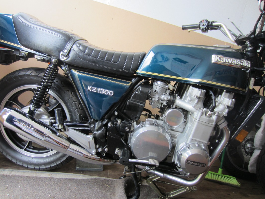

My KZ 1300 darling is a US model, 1979 A1 that was originally sold in Bozeman, Montana (Jan, 1980) and which I picked up last year from Australia. It was in fairly original condition, abet, 40 years old and needing some desperate TLC - the seller did say that it was a runner…
Upon receipt of the bike (here in NZ), I have been methodically working my way through it one section at a time to get some idea of its maintenance history and to identify any pressing issues. – I didn’t really want to do a complete engine out/strip down and rebuild (unless I had too), and just wanted give it the once over, clean it up, maybe re-do some paint/plating/polishing, get it going as a period survivor and ride it...
One day last week was a milestone event in that I started it up for the first time and was able to complete the (running) carb adjustments -slide synchro, air screws, fast idle and bleed the radiator etc...
It has been a long road - mostly undulating tar seal although there were a few rough patches and pot holes…

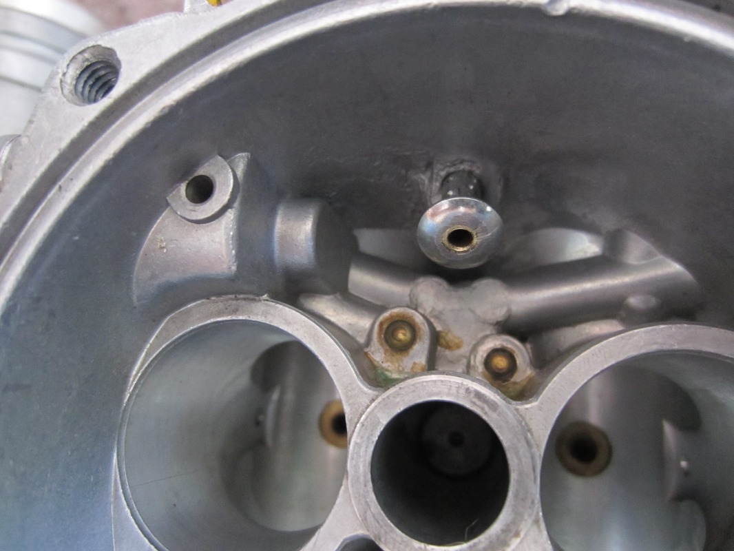

I did have to give the carbs the full Monty…
Aye, when I dropped the carb float bowls, I found nasty black sludgy lumps and rust particles, so it was a total strip down and clean using the “Scotch” cleaning system and tool. While I was there I replaced the pilot jets (new), replaced two slide diaphragms, two needle jets, all O rings, a couple of float bowl gaskets, adjusted 2 out of 3 float levels and modified the choke starting circuit as per scotches post (used rivets and 1/8 brass tube as I couldn’t find any suitably sized silicon tube).

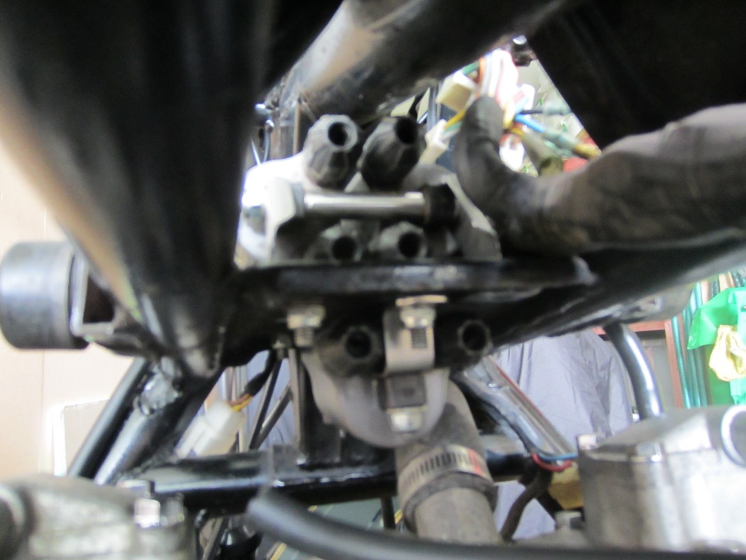

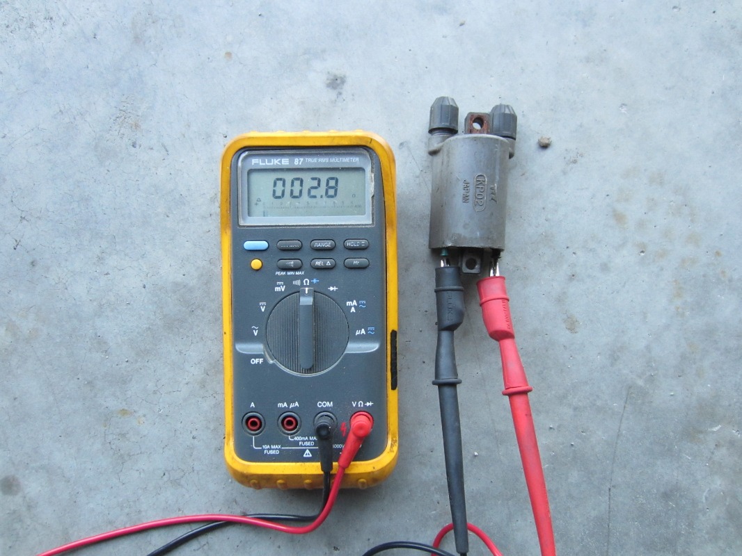

The coils that came on the bike were 2 x Axcel (at 3.3 ohms each) and 1 x unknown brand (at 2.2 ohms).
That would not do, so in the interim I have installed a set of ZX10 B series coils which have a primary resistance of 2.8 ohms and a secondary resistance similar in spec to the original KZ coils (I read TrkBr’s post regarding the need to protect the igniter by using a ballast resistor and may install one and suitable coils at some stage down the track).
The ZX coils are physically smaller so I could fit two coils up and one underneath, time will tell whether the heat fries them or not…

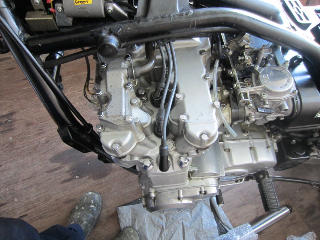

I left the motor in the frame and dropped the oil pan to check the oil pump pickup screen, which was reasonably clear and measured (as best I could, looking up from beneath, dodging the falling oil drops…) the slack of the primary and secondary drive chains which I reckoned to be less than 15mm.
Maybe, this bike has either had an easy life or has had new chains at some stage.

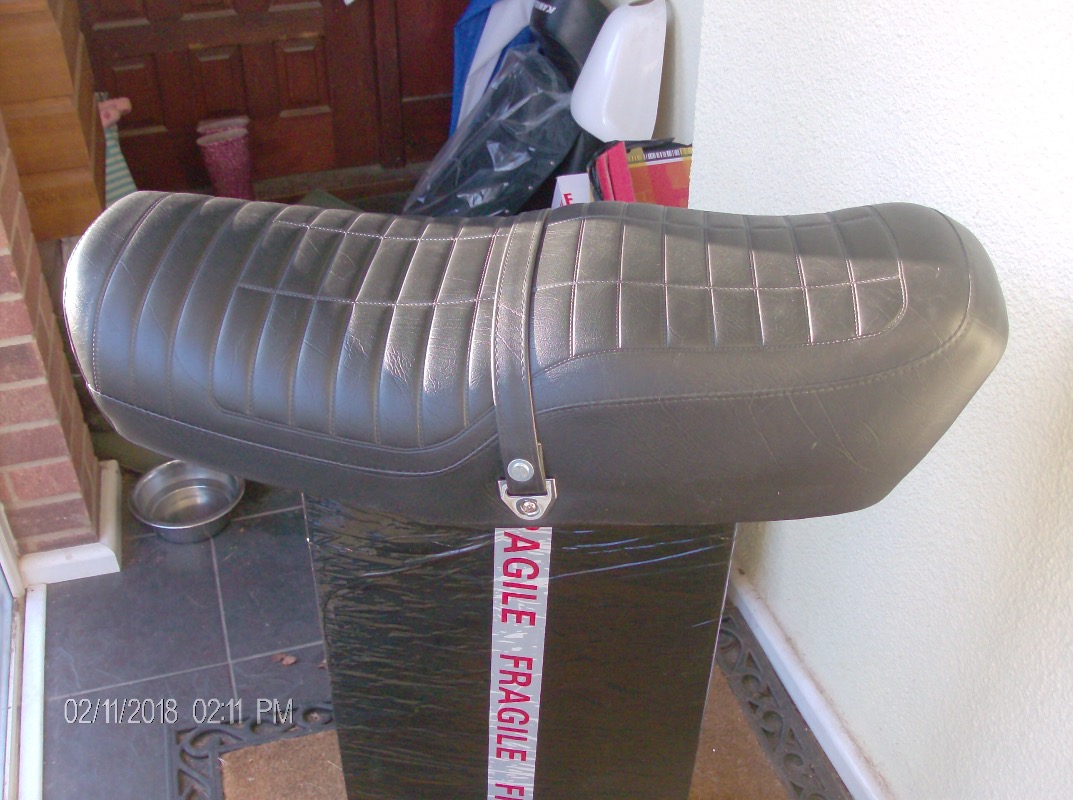

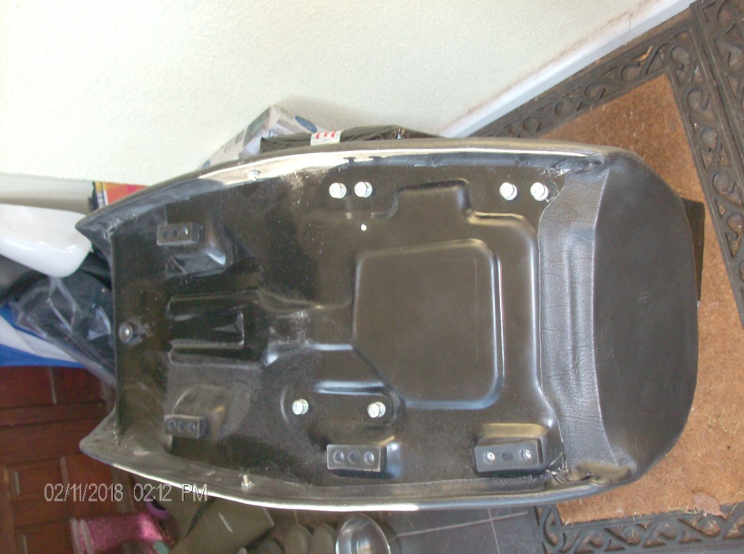

On the headlight ears. I may have one. My left side has been straightened (not well). But the right side looks ok though I’ve not given it a critical eye. I have a ZRX fairing coming so won’t be using. But they are worth serious money.
In November I bought a seat from Bob-the-Seat in the UK. He provided me with a complete ready to bolt on seat. Fiberglass pan, new foam, strap, buckles, rubbers and cover. Shipping to the US was not cheap, but the seat was a very good deal and I’m quite happy with it. He will sell any and all parts as needed.
Pictures are from Bob, but it showed up exactly as pictured.
