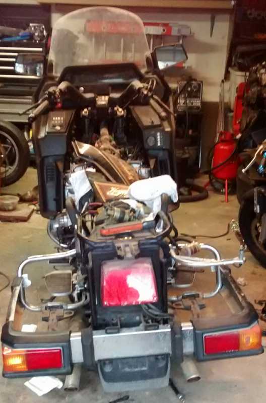

From a few days ago the garage is a big mess at the moment. I got it complete and still have everything just easily to mess with fuel routing and the battery like this. This bike certainly needs to go on a diet I don't really think I could ride it like this. Currently thinking of doing like many others before me and stripping it down. Nothing crazy just remove some of the mass and see how I like it. You may see all the luggage and fairing bits up for sale one day.
