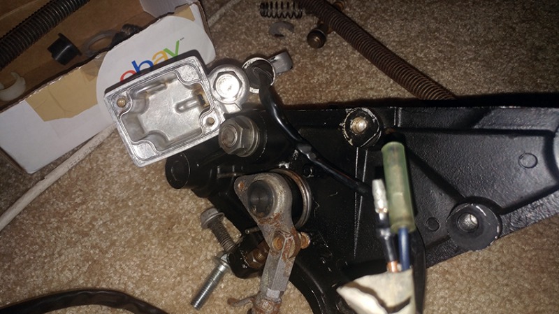

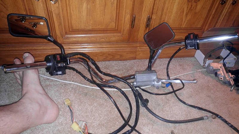

Another mock up of the handlebar. I've had no success following on a promised one, among other crucial to my restoration parts, made with one of the forum members, but I am not out. Got this handlebar, took apart completely rotten master cylinders and controls. The master cylinders need re-sleeving. I am in the process of a DIY rescue. So far stripping, cleaning, and sourcing parts.
All the electrical/mechanical controls have been disassembled and rebuilt. Except the top painting, which I am not in a hurry to do. This and lettering will come as ice on the cake once I am sure all works properly.
The mirrors are from eBay. Love the square shape and field of view when I sit in my chair and watch my back! HAHA They were listed as similar year police model. The plastic needs some attention (please any plastic refurbishing tips come in!), but the perfect mirrors were what sold me on these.
So here we go with yet another mock up:
I also finally removed the stuck broken lid screw of the rear m/c. All is ready for re-sleeving and then painting. Then - assembly!
