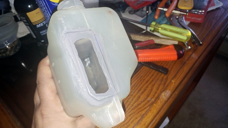

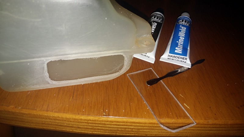

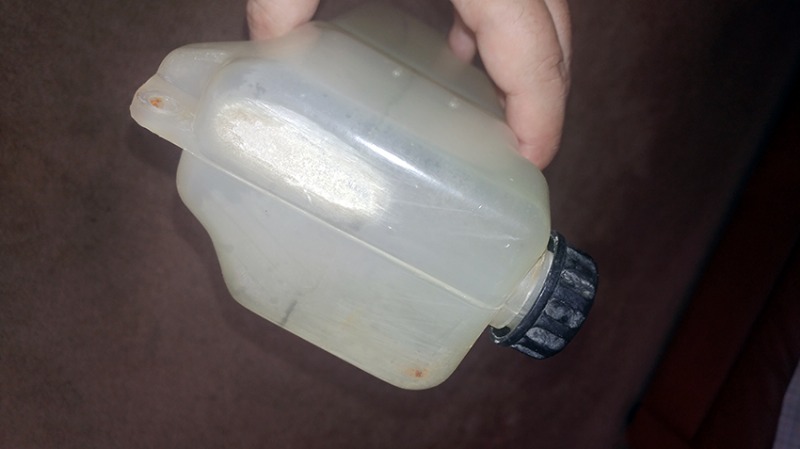

#17971
The coolant overflow tank fix. In retrospective, I'd replace a larger area and apply less JB Weld. It still looks fine and I will be able to actually see the level.

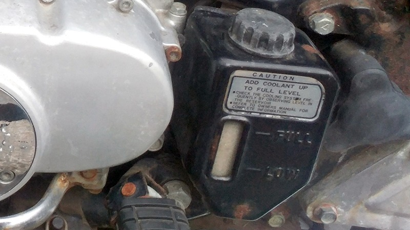

#17972
This is how it came

#17974
That fix looks pretty slick. I'm interested to hear how it holds up - my guess is that it'll be fine. I repaired an oil pan leak on my Jeep a few years ago using JB and it's still holding up fine.
