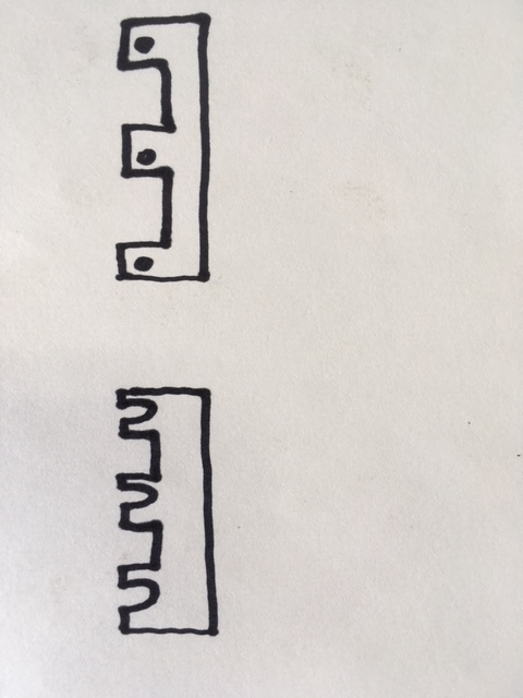

Nice, neat wiring on the examples in the photos ! For others considering this option I'll screw things up with this suggestion:
Keep the OEM "Single" power feed to resistors and make a "Buss-Bar" that connects the 3 resistor inputs. Then attach the single power IN lead to any one (1) of the "Bussed" screws.
A crude illustration !

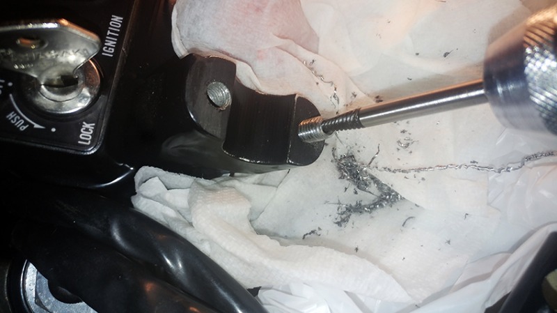

Not really enlightening wonderful news of technical nature, haha - just to document and a follow up on the 'three bolts only' on the handlebar question.
Now all is fixed.
Now all is fixed.
