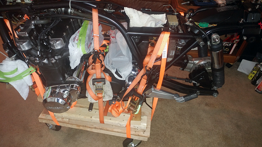

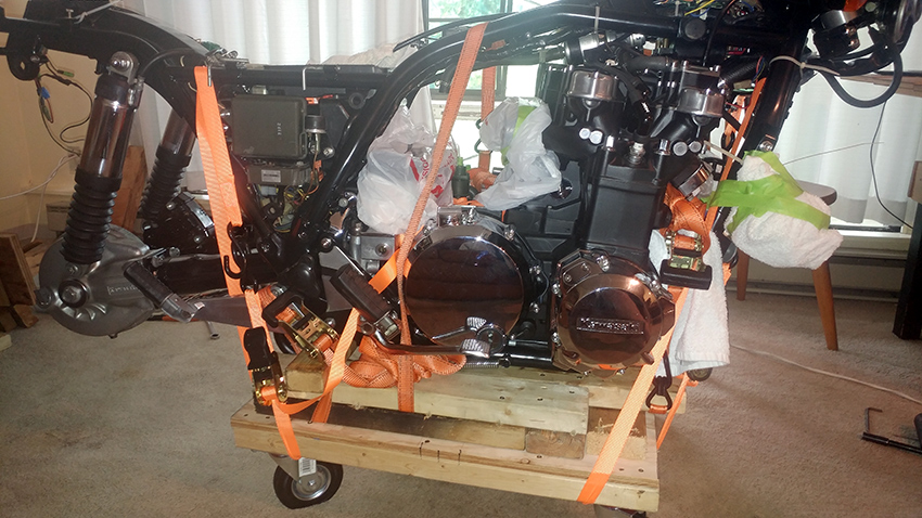

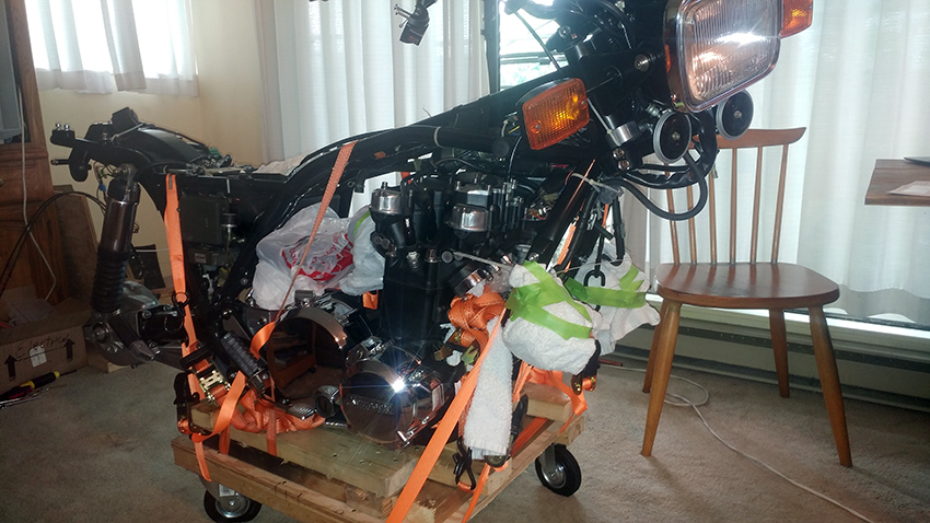

Final pictures of the bike at my place. Tonight it will be standing on a solid ground!
I used four 5 inch swivel caster wheels, each good for 220 pounds. With the straps, and of course long screws for the wood, it's all solid like if made from one piece. I can move and maneuver the bike with ease just by myself, even on the soft carpet, holding it by the frame. The assembly will begin and I should be riding it in a few short days

Just to report that the bike is on the ground and already on it's two wheels. It went very smooth, maneuvering it was very easy with my two hands. No strain at all! The key for such ventures is to have four swivel caster wheels.
I am doing a few 'small' things now, and tomorrow the whole exhaust will go on the bike.
