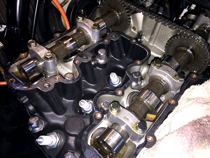

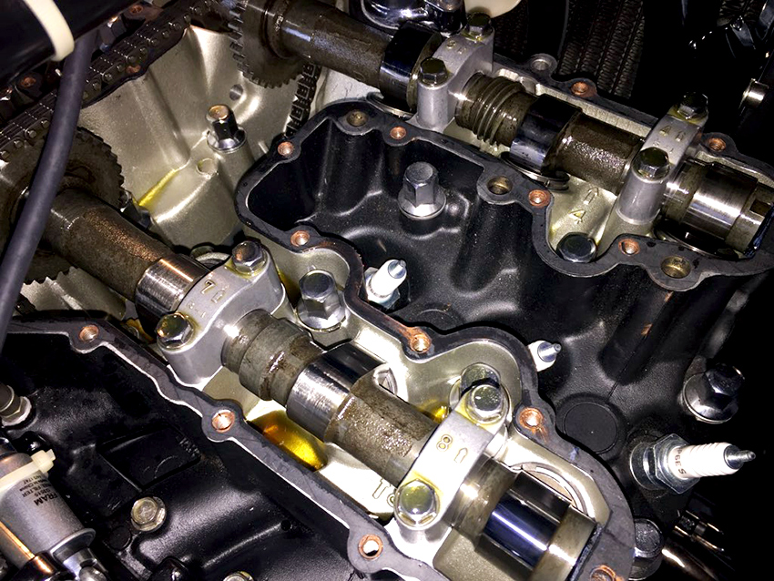

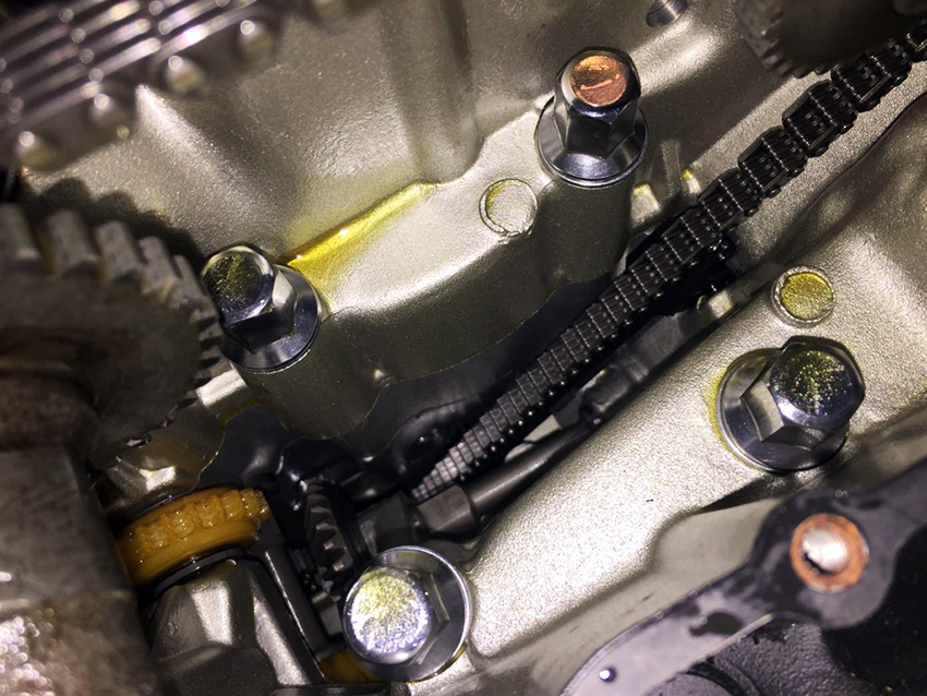

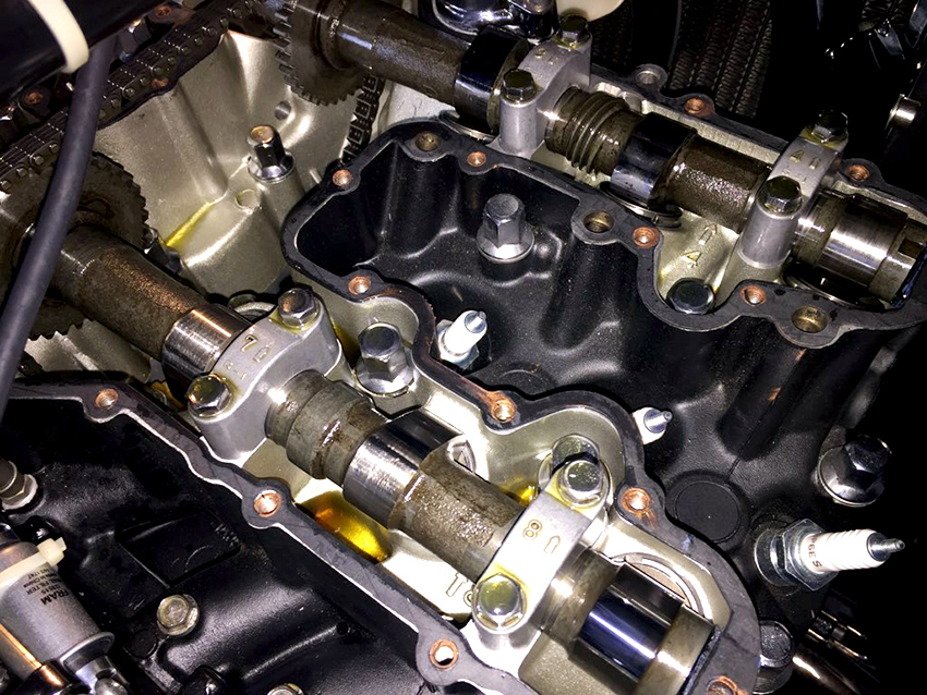

What else... Oh, that's right! Removed the cam cover! Things look shiny and clean. I am very happy. A peek inside the engine showed more of the same. I am very happy and that's an understatement. Of course, the whole purpose was to re-torque the cylinder head nuts. Applied the 29 lbs./ft. to the main nuts in the sequence per manual three times, and the required torque for the four smaller 10 mm bolts, until nothing moved. I didn't measure the exact numbers, but if someone wants to take a note for reference, all main nuts turned about 15 - 20 degrees.
Here, for nostalgia, a few current photos of the cams after 300 km. Next will be after the braking in period for valve clearance adjustment, and that's after another 1300 km. That should be it for opening the engine.

Out of interest Stan, did you put your cam cover gasket in dry both sides, or any sealant on the bottom side to hold it down consistently?

Thin layer of sealant on the head, the top just smeared with some oil. It was sealing very well and came off equally easy.
