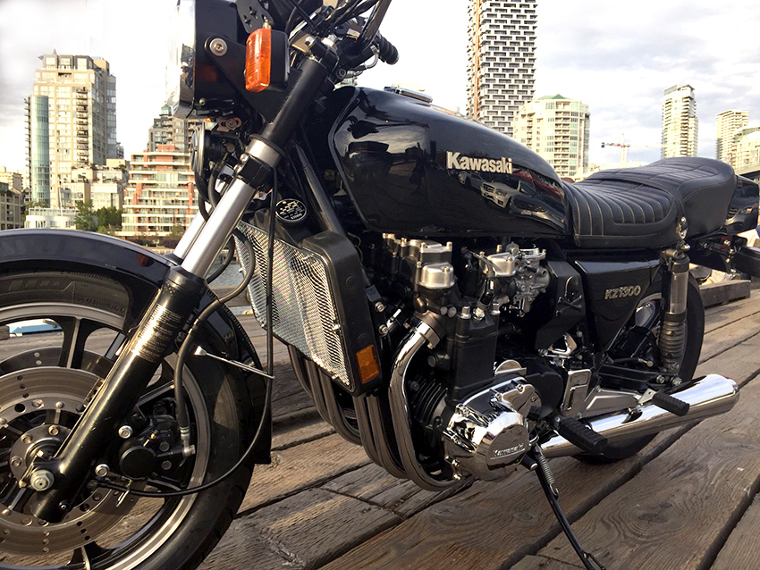

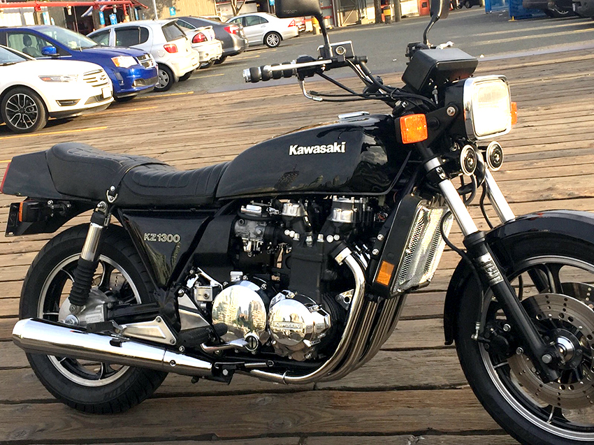

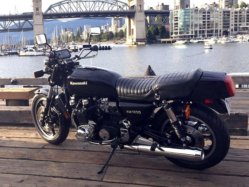

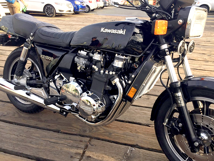

Not ideal photos, but from the road.
Got the first 30 km on my first day.
Riders in BC - great idea. Lets meet!
Last edit: 7 years 9 months ago by StanG.

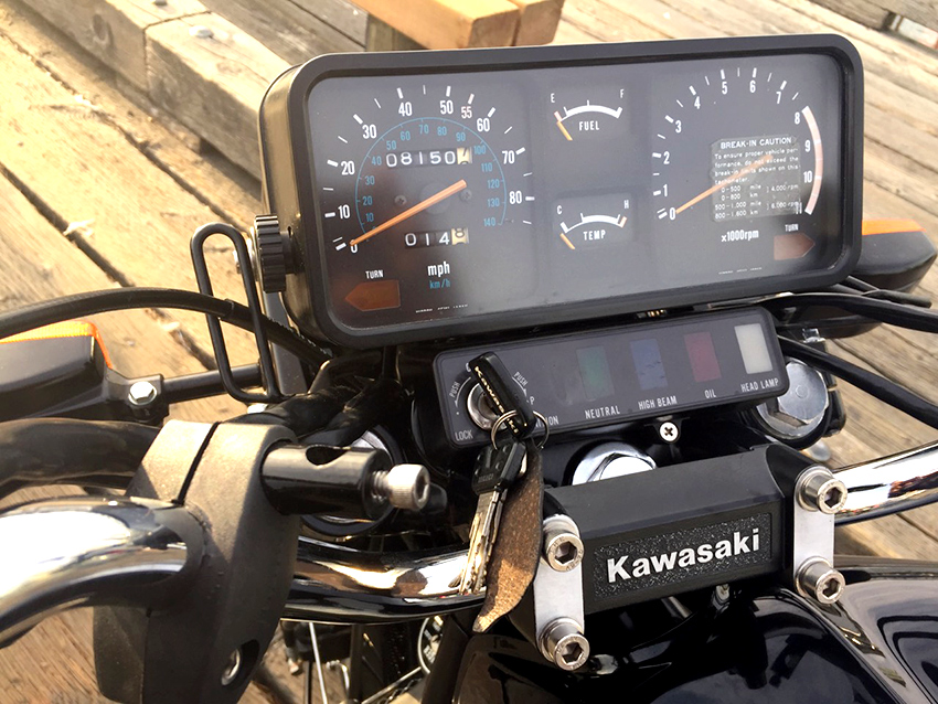

I am taking the '8150' as a new zero mark, as pretty much it's a new bike.
