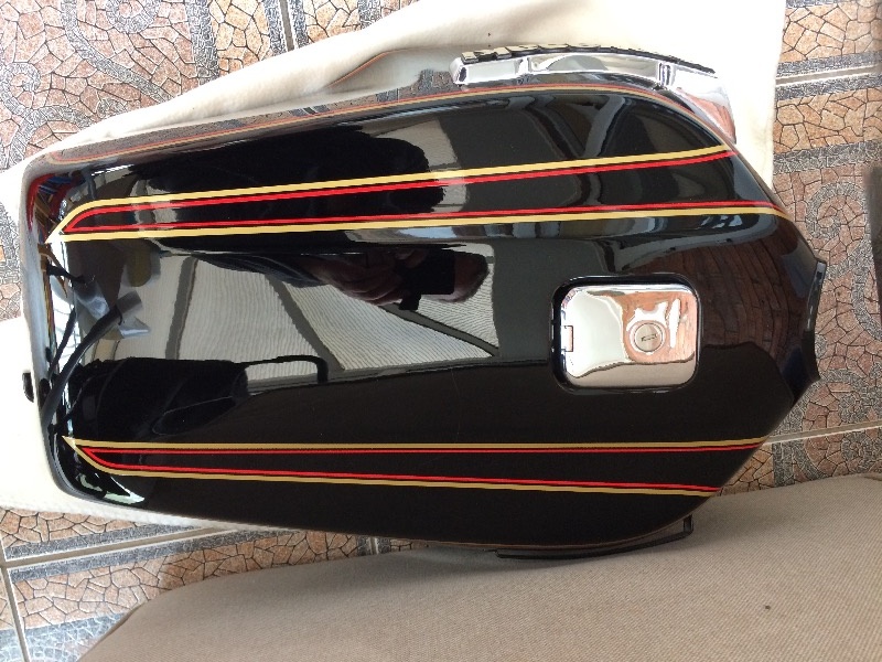

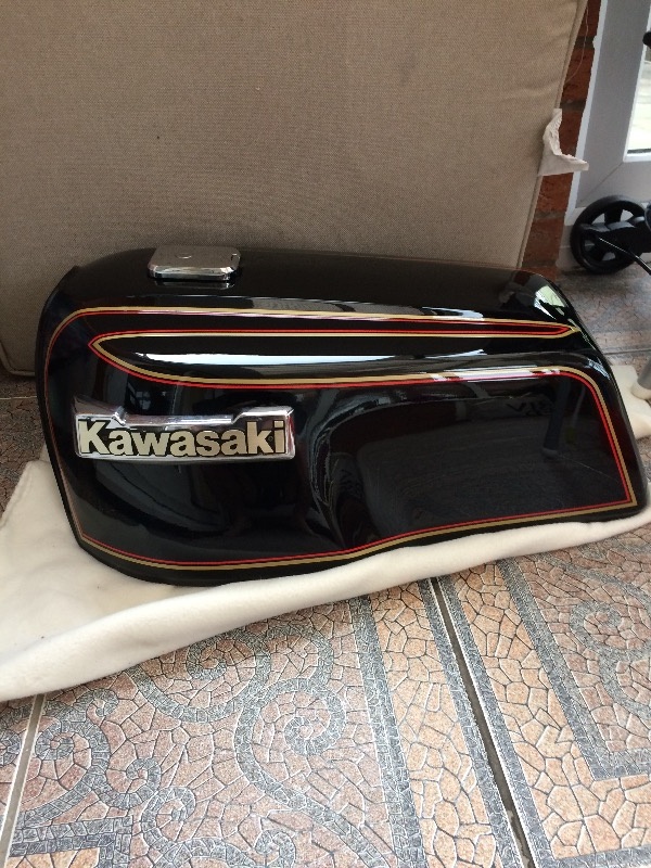

The fairing is not going back on the bike and I’ve aquired a second hand petrol tank (which I’ve had painted) to fit to the bike rather than the peanut shaped one.
