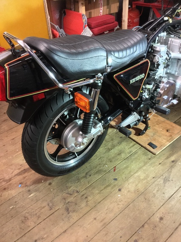

Hope you're gonna polish that tank before you fit it Mizzy :woohoo: :woohoo:

Nice work ! An excellent example of the 13 !

Your bike looks awesome. You must be very pleased.

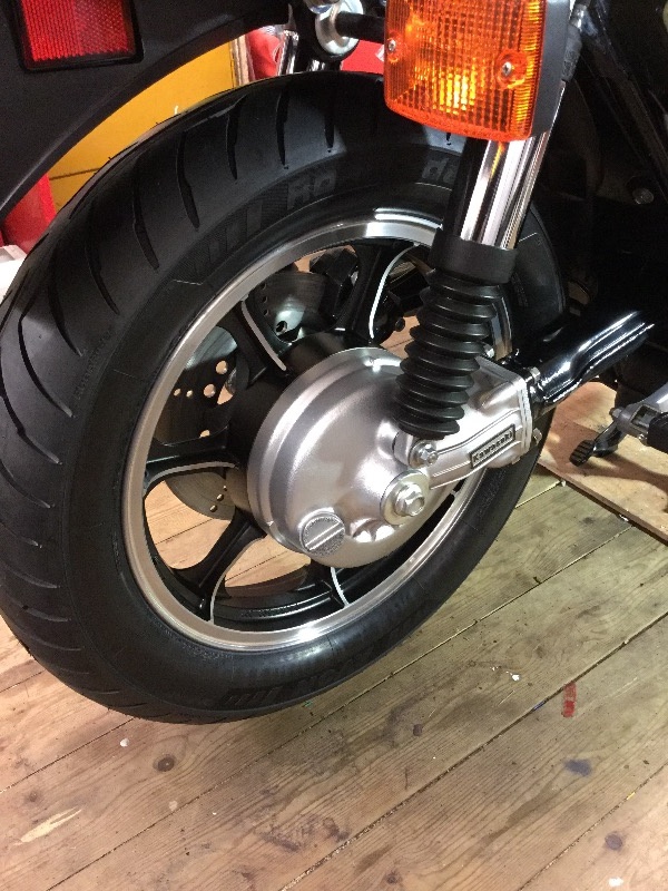

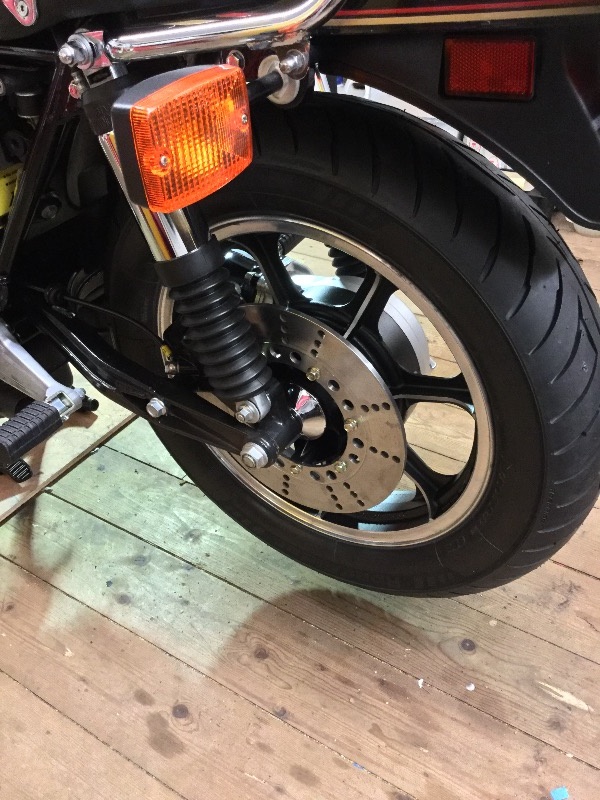

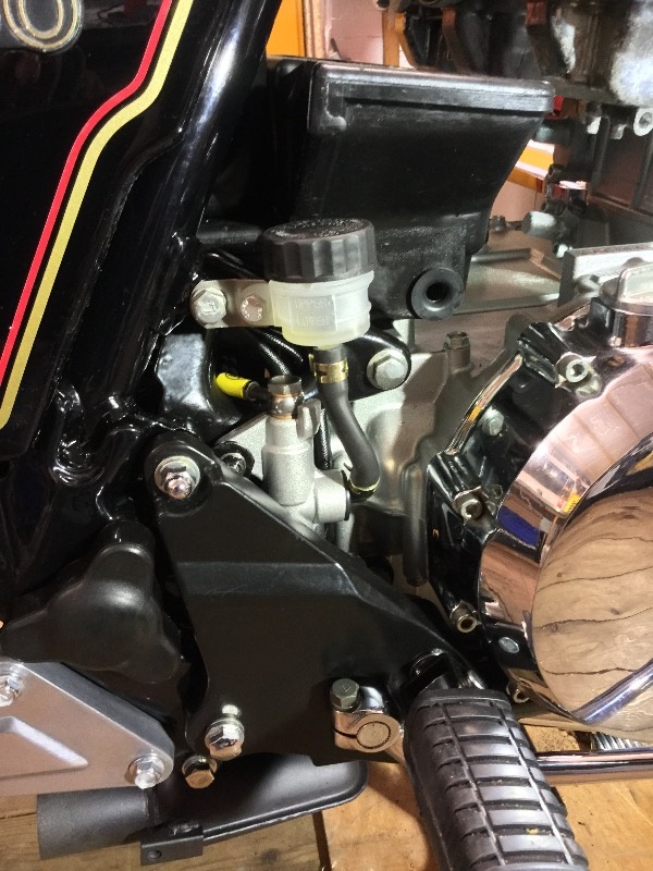

Rear wheel and diff are now bolted in place. Rear brake has been a problem as the sleeve in the master cylinder is just too far gone. Had to make a few modifications and fit a after market master cylinder. Seems to work fine.
