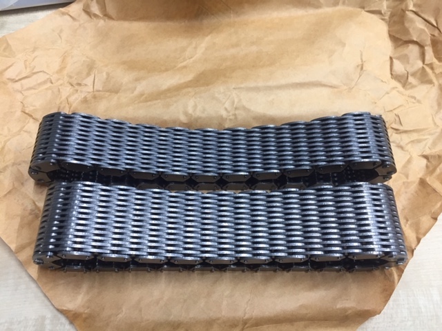

As I am having no luck finding anyone willing to take this on, I have decided to at least open the crankcase case myself and see what's what. If that scares me too much, I will simply bolt it back together and continue the search for a mechanic. If I feel confident and can see better how it all goes together I may attempt the chain swaps myself. I have ordered the chains today - they should be with me early next week. GBP 119 (USD 150) per chain delivered is not bad.

And hereunder what turned up this afternoon!
Paul

Great! The chains I have seem very solid when playing with them, but a real test will be when having them assembled.
