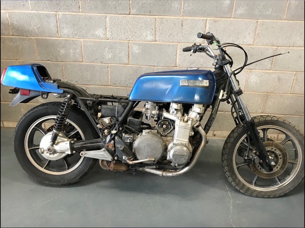

Hi all,
I took the plunge and two months ago bought a basket case 1979 KZ1300 A1. Pic as bought hereunder.

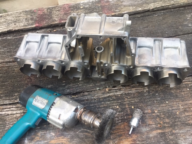

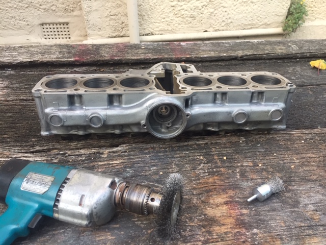

Situation now is that I have taken the bike and engine apart completely as everything was rusted stuck. After a month soaking in diesel the pistons were still stuck, so I had to resort to a mallet, a block of wood and a good hour of 'gentle persuasion'. The liners had already been over bored and were so rusted there wasn't anything left to do with the block other than use as a boat anchor, so I needed a new cylinder jug and pistons. I found a good second hand one in the US (I am based in London) and I got that reground. Top end just needed cleaning, valve lapping and head skimming.
In the meantime I'm starting to think about paint scheme for the engine. Sliver aluminium block with anthracite grey covers and black bolts is the current theme, but finding heat resistant paint other than silver and black, and a large enough oven to bake the parts in is difficult!

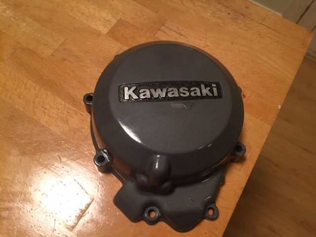

Update for today is that I have cleaned the jug with a few basic tools and am half way through masking it for paint (how does one get clean masking edges with curved sections?? I tried knifing the overhang with a Stanley knife, but still not a very clean cut).
I have also spray painted one cover as a test with Motip heat resistant paint, colour Dark Anthracite. I chose this as it can go directly on (sanded) aluminium and for curing can go into the oven for 60 mins at 160C. Having done that the paint still felt a bit soft, but more disappointingly, it was matt. So I covered it with some Simoniz clear lacquer (although not sure if that is heat resistant) to get some gloss. Hereunder a pic of the result. Looks OK - apart from the blemish in the middle where eager-fingers-here tried to feel if the paint was still wet (it was!)
...grr... some polishing to do.
Anyone have any ideas where I might get heat resistant paint colours other than black and silver? Most heat resistant paints are not suitable for aluminium....
I have heard Hammerite is heat resistant, and for water-cooled engines that don't get so hot that could work... they have a very nice dark grey and I know that finishes gloss and rock hard, which for the covers where the boots rub, it will need to be.
Paul

Hi McBoney, just a word of caution from past experience. The Alt cover in the picture be very careful that you don't overtighten either of the two lower bolts at the bottom of the cover as there is no support directly behind the cover there you can easily crack the cover behind the bolt hole and end up with a oil leak. And you may think its the gasket by mistake.
Just my 2 cents worth
