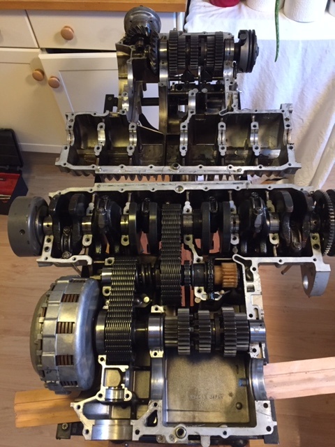

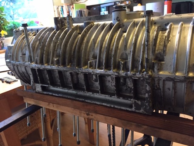

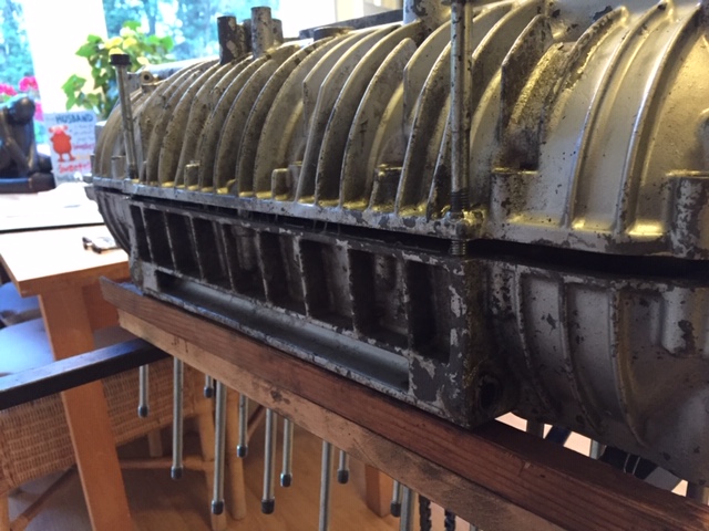

Ok, so I couldn't wait and got spannering. First the block from both sides before I started.

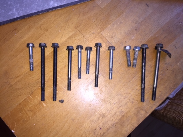

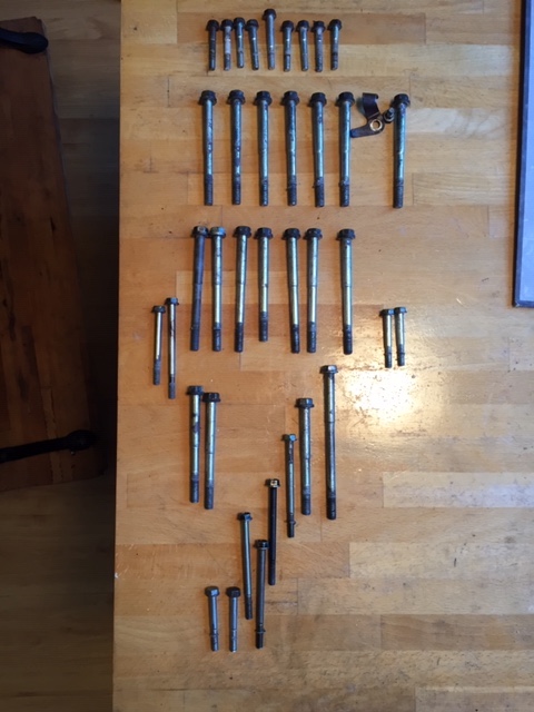

Then the upper crankcase bolts, in order that they came out, from left bottom to right top corner

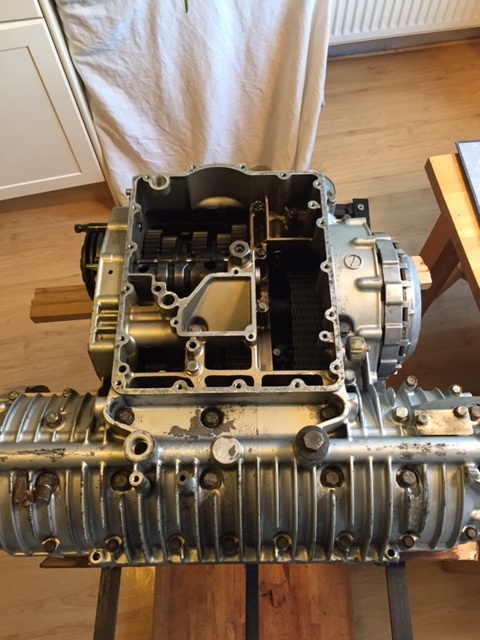

Then turn it over
Then the lower case bolts, placed as they sit in the block

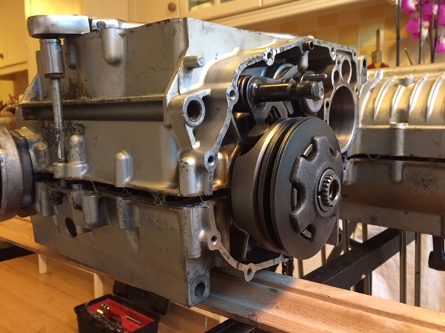

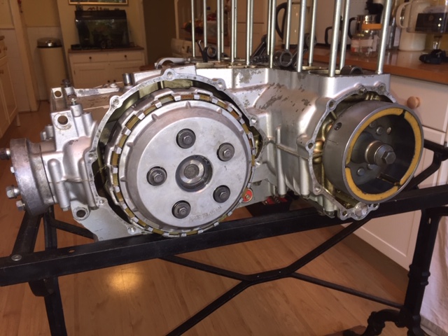

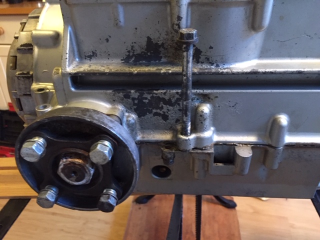

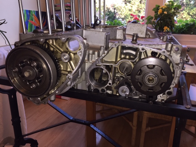

Then insert three 8mm bolts in the holes provided. These were full of rubbish, so GOOD cleaning and then lots of oil to help the bolts screw in.
...and ... OPEN SESAME! :lol:
One crankshaft bushing fell out, but easily identifiable where that come from.
