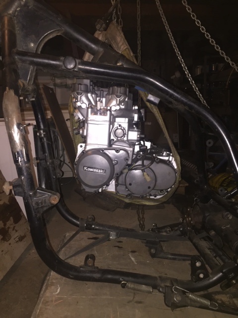

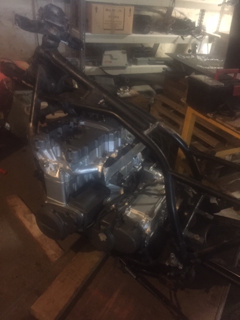

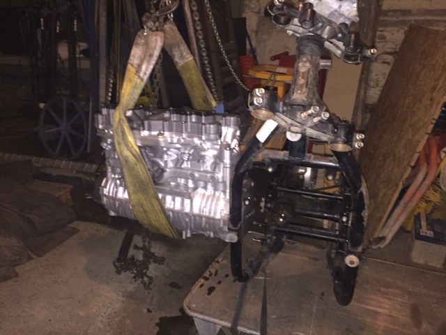

Right, that was a bit of a job, but it's in! I hoisted the engine up and strapped the frame to a dolly on wheels so I could slide the frame around the suspended engine.
Initially it just wouldn't stop fouling the frame, until I figured out I had forgotten to take two engine brackets off (doh).
Then I lined the whole thing up again
and with quite a bit of manual pulling and shoving it did eventually drop into the frame.
Only thing that suffered was the LH breather cover, but that can easily be taken off and repainted..
