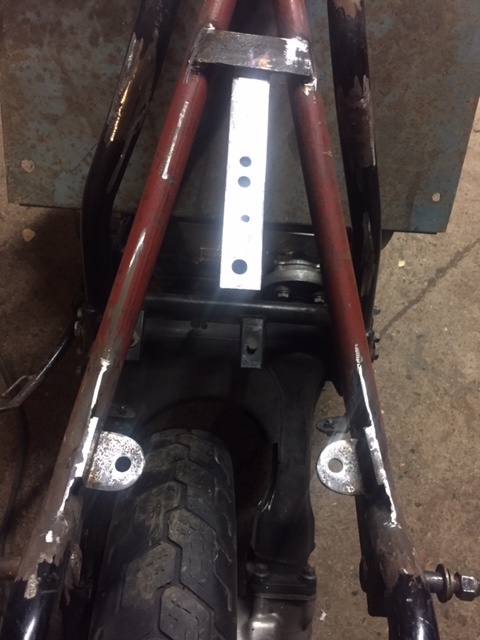

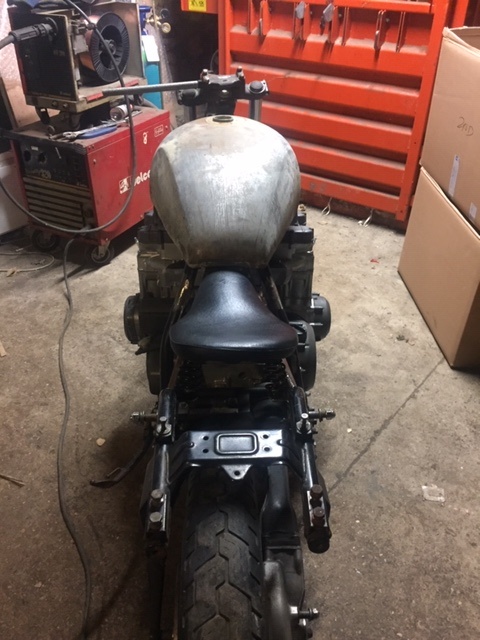

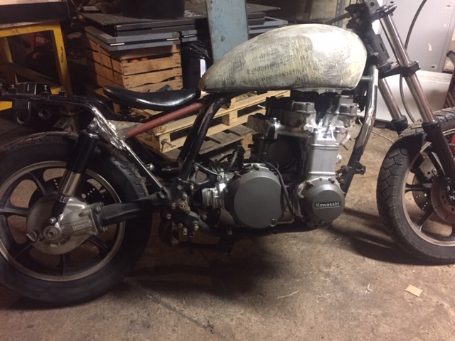

More progress... tank is now securely clamped to frame at the rear, seat brackets also installed and presto! I can sit on it again!
Still a little wonky, so needs adjustment, but that is a matter of fettling...
