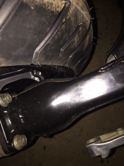

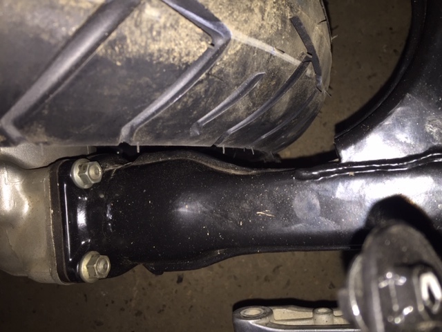

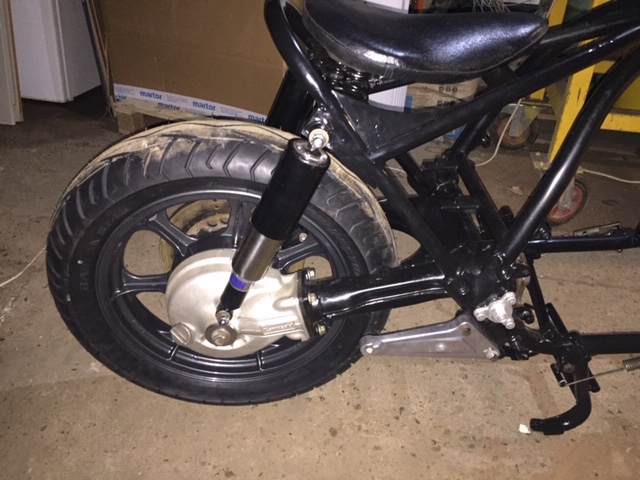

In the meantime my new rear tyre turned up (front still not in stock). I got it mounted and balanced (and annoyed as they chipped my new powder coat!) and got it onto the bike. This is a Bridgestone Battlax BT45, 150mm wide, and if you look at the pics, these fit the swingarm fine with at least 1-2cm clearance.
Once the front tyre arrives and I have sorted the triple tree conundrum (see other thread), the engine can go back into the frame and then it will start looking like a bike again.
