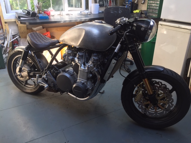

My friend said to that so I did that last night, but it didn’t do anything. Rear is fine now. Front handle still going to the bar.
Concentrating on electrics today, the parasitic draw was so bad it blew the 200mA fuse of my multimeter. I have isolated the wire that has the issue but that goes to the coils! Not sure what to do now or how to check what is wrong.
The rubber hose was not petrol resistant. I have replaced with Mercedes left over hose, should be ok.
Paul

Latest test results to find the potential parasitic draw:
When ignition off and the M-Unit connected, the draw is 0.1 on the 200mA scale. To me that is nothing and doesn't explain the battery going flat overnight. When ignition on, the wire that draws the most amps is from M-Unit (ignition out) connected to:
1) coils
2) ignition module (yellow/red)
3) speedo (the switched live wire)
If I take that wire off the M-Unit, the total draw with ignition on is 44, which I guess is the M-unit itself. If I connect:
1) coils, no extra draw
2) Ignition module, it jumps to 120
3) speedo, it jumps to 88
All three together it goes up to 164... no idea if that is normal. But crucially, when ignition is off, there is no draw... ?
I have reconnected everything and checked the parking light option (off) and also disabled the alarm. See what tomorrow brings.

Well, battery full this morning. All electrics working again.
I did some head scratching and I think I know what happened. The M-Unit starts up when you start up the app on your phone and get close to the bike. Then you press the starter twice to switch ignition on, then press again to start the engine.
Press twice to switch off and then twice again to switch off the ignition. But if you switch on/off with the key - which I was doing intermittently - you can leave the ignition on without realising. That will drain the battery.
I just have to make sure I switch the ignition off completely when messing around with the phone app and the keys. If I use one or the other, there is no issue.
I took the carbs off to address the slight vacuum leak I had between the carb rubbers. I took the opportunity to reset the mixture screws - all 2.5 turns out. It idles nicely and revs as well, but sometimes the revs still 'hang'. RH side carb is also spitting back fuel through the air filter on occasion. I have ordered a synch set, so when that comes I'll do that and see if that makes it better. It starts on the button though!
Also awaiting Triumph UK to re-open so I can order the brushed aluminium seat pan I need for the bobber seat I have been given. Currently it is sitting a bit low and too far back.
Front brakes still a mystery, but overall its getting there!
