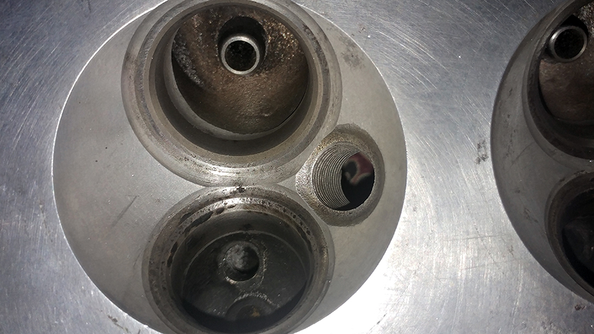

This is the pitting on the head before machining. (it's not the current head I am working on but the one already on my running bike)

Yep, that's pitting on that exhaust seat. If you removed that via lapping, it would widen the sealing surface noticeably.
This is the lapping tool I have: www.amazon.com/gp/product/B07C6QK2BW/ref...01_s00?ie=UTF8&psc=1

7 years 7 months ago - 7 years 7 months agoYep, that's pitting on that exhaust seat. If you removed that via lapping, it would widen the sealing surface noticeably.
Yes, that's the fine line. These had to be machined. The other head intakes are fine, but exhaust will need machining as well. Once done, most likely it's not going to be looked at sooner than 20 years.
