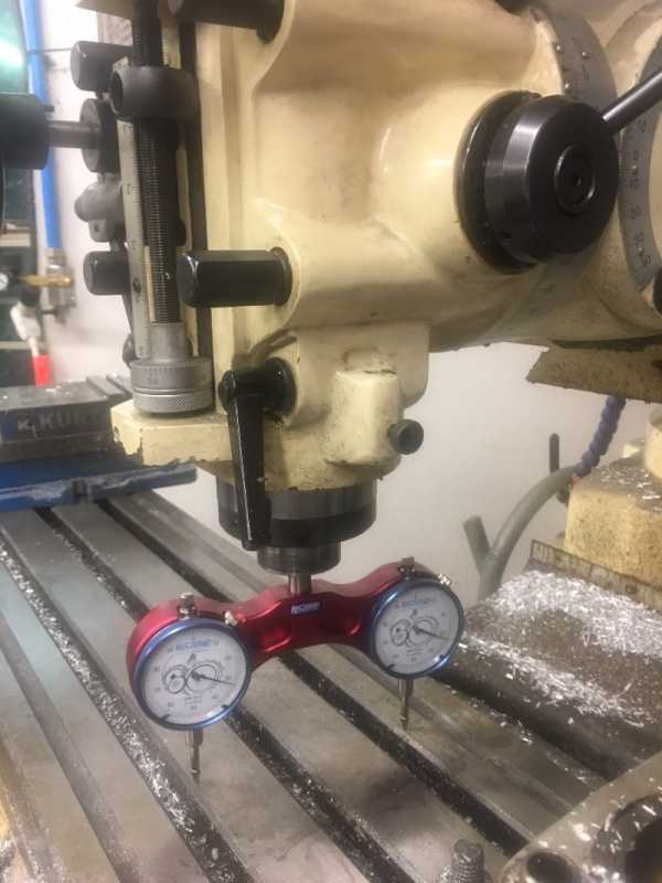

Tramming the mill in preparation for boring...

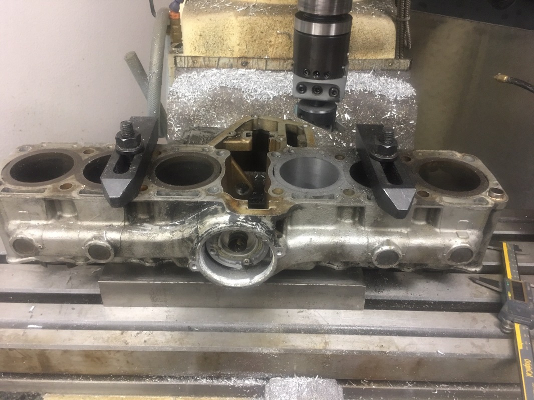

Boring in progress

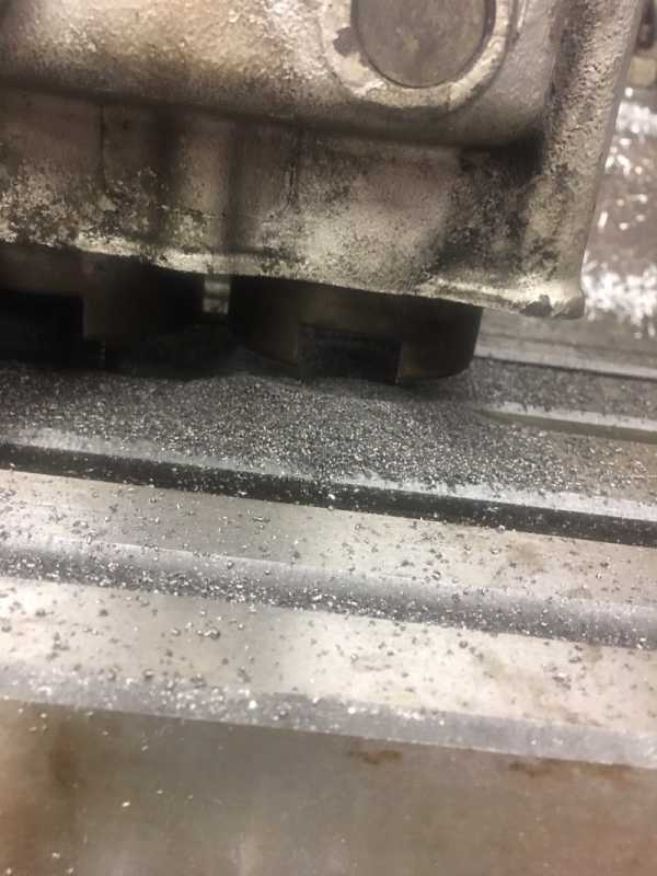

When folks talk about machining something to go over the liner, they are talking about this potion that sticks out below the cylinders. That liner support would ONLY be used during the boring/honing operations. The case supports this part of the liner once assembled. I chose not to make the support and just limited how much material I removed each pass. As this portion is an interrupted cut it is important everything is rigid.

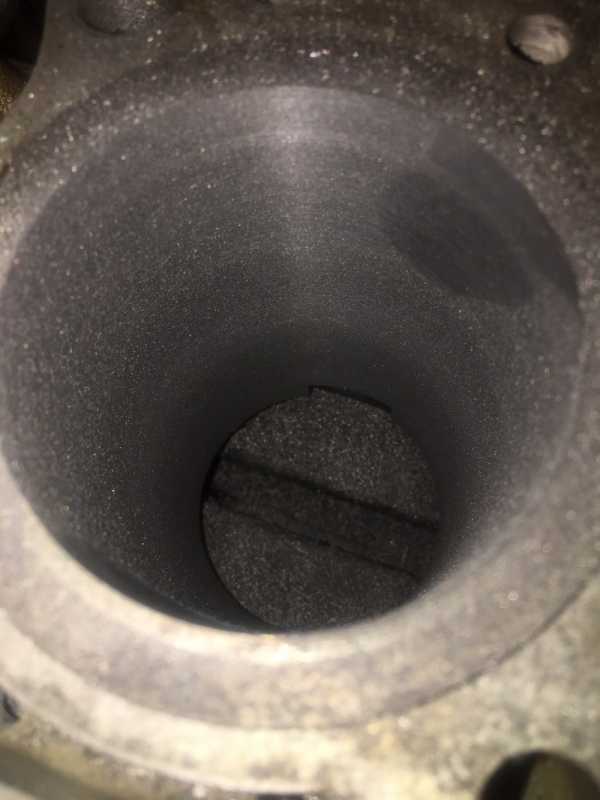

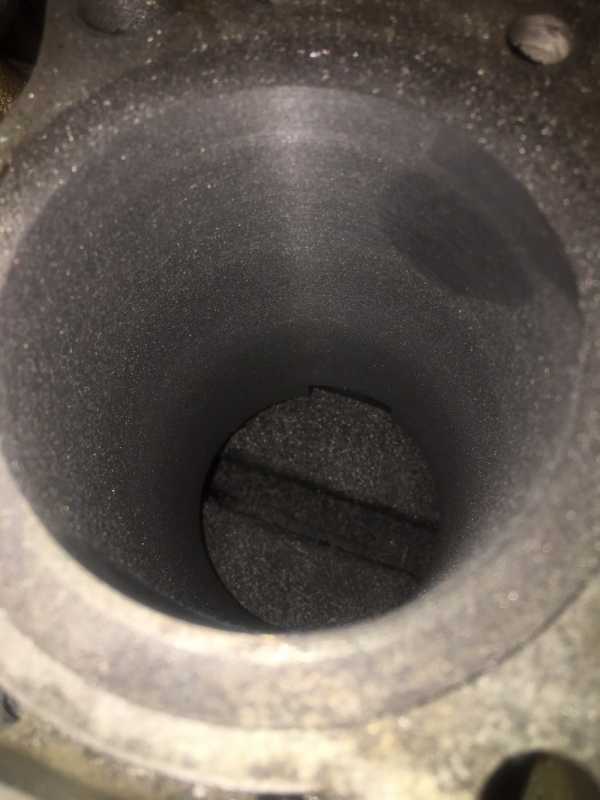

A freshly bored cylinder (not honed).
I bored 2 cylinders last night. Took it slow, ended up doing about 5 passes for each cylinder. My Ammco hone, at 2.5" (63.5mm) is just barely small enough to do these cylinders.
Boring in progress

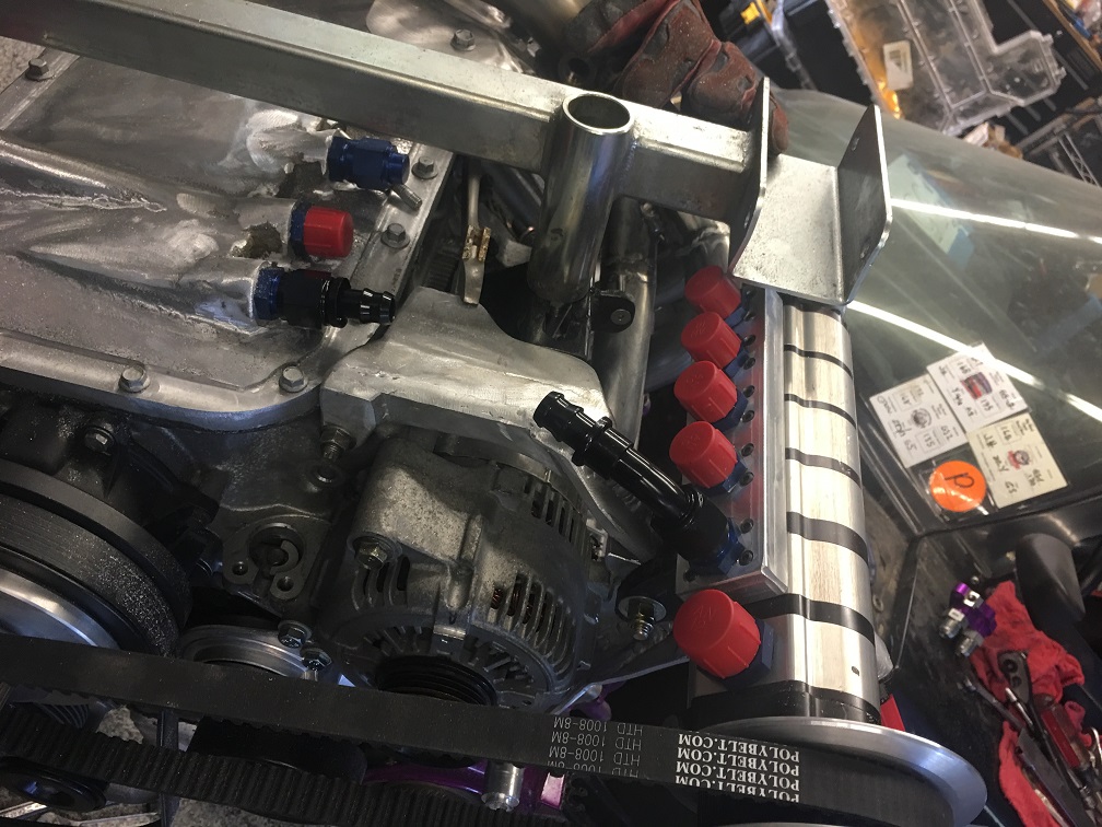

So now it's back to squeezing this dry sump setup into the car. I did cast the oil pan in the picture in my back yard! May cast my own design KZ1400 emblems for the bike.
