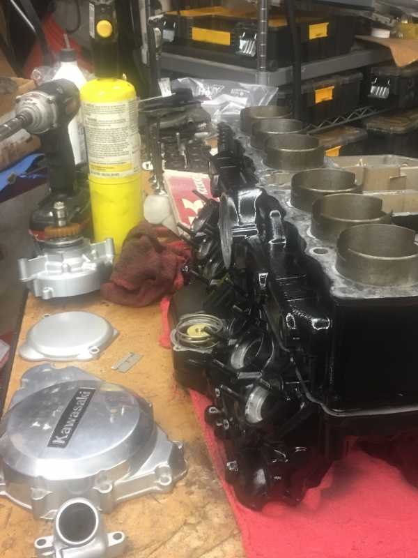

Looking good Frank!
I wonder what paint did you use. Looks shiny.
The valves in the back, are they new or are you going to re-use them? And did you machine the seats or just lapped the valves?

I cleaned all the valves and lapped them. I had planned on putting in new valves but these, the seats and the guides are all good.
The exhaust side had heavy carbon build up. Worst I’ve seen since a motor I was into in 1981. Had to chuck the valves up in the lathe. Used paint remover and pressure washer to clean the ports.
Have valve seals and springs on their way.
I ground down the more visible casting marks on head & cylinder, then used VHT engine paint and VHT engine gloss clear.
