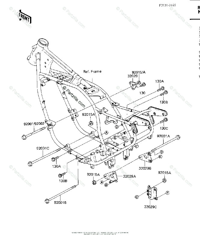

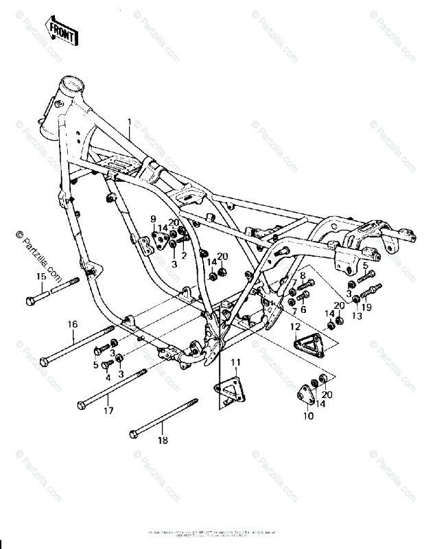

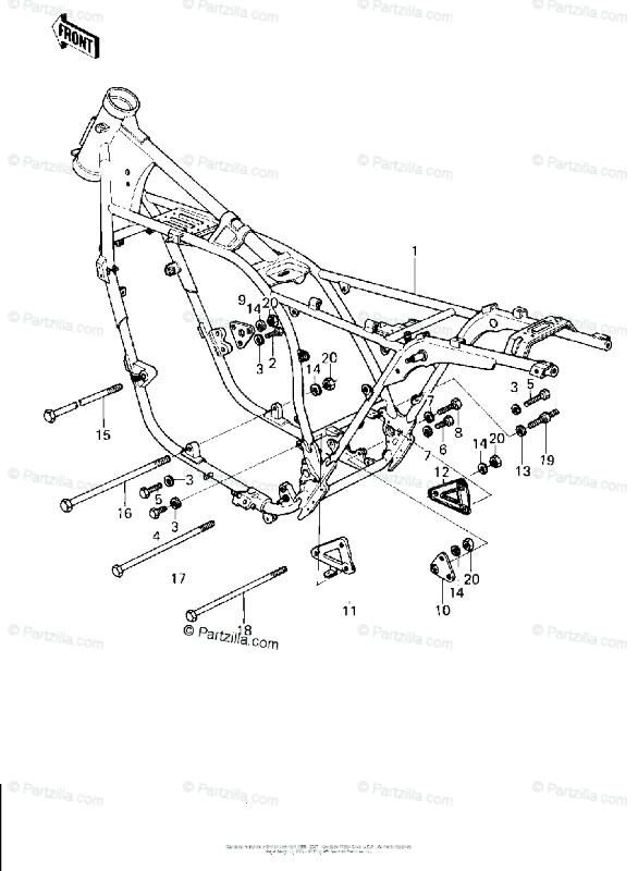

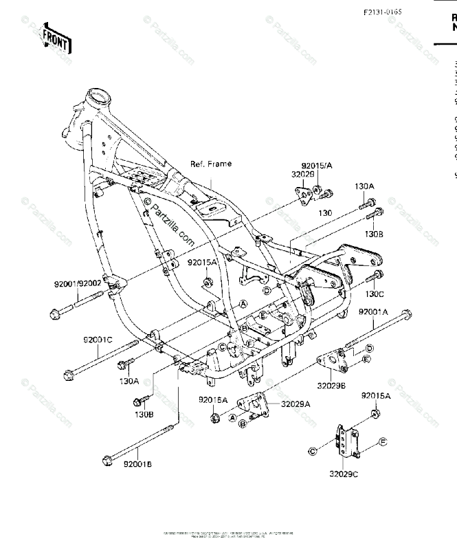

Voyagers (ZN1300) have a frame that is significantly different than a KZ. You can tell some of the differences from the part diagrams and others by looking at the bikes.

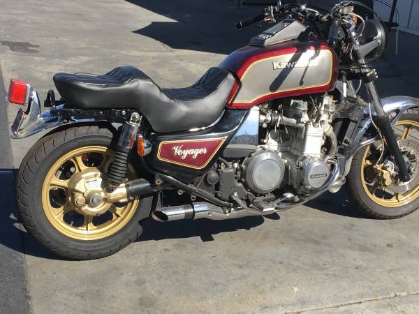

Here is a stripped down Voyager that is for sale:
sfbay.craigslist.org/pen/mcy/d/naked-kaw...1300/6747419149.html
The most noticeable differences (for me), are the lower seat height, the different shape of the frame around the side covers and the shorter tail.
