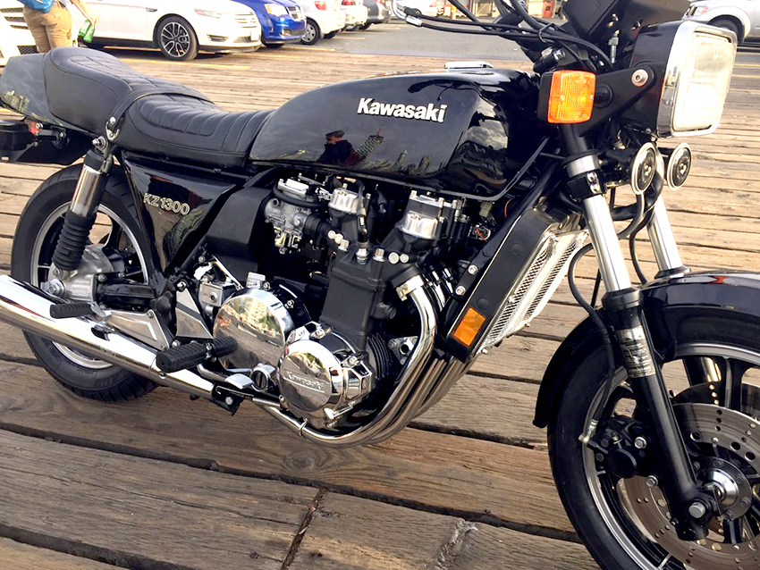

7 years 6 months ago #22215
by StanG
Thank you!
Replied by StanG on topic KZ 1st. Build ?
She is gorgeous!
Thank you!
