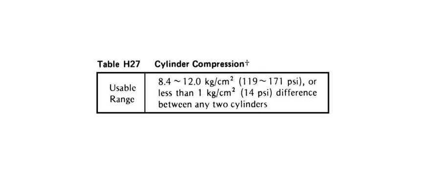

What would be the tolerance values ​​for correct operation?

From page #182 in the Service Manual. I would be happy if you found 130 PSI  (9.14 Kg/Cm2 )  with no more than 10% between cylinders.
Be careful with a borrowed compression tester. I found out the hard way that compression testers have a special Schrader valve with a very light spring. Many people have replaced the Schrader Valve with one used for a tire and it will cause a compression tester to read as much as 40-50 psi lower than the correct reading. Schrader Valves for compression testers have a break out pressure of 5-8 psi meaning that it takes 5-8 psi to open the valve. Most tire Schrader valves need 20-30 psi to open the valve.
Compression testers are great for a quick check but if you find a problem, you really need a leak down tester to determine what is the problem. Leak down testers will tell you if you have a bad valve ( and which one) , a bad set of piston rings, or bad head gasket.

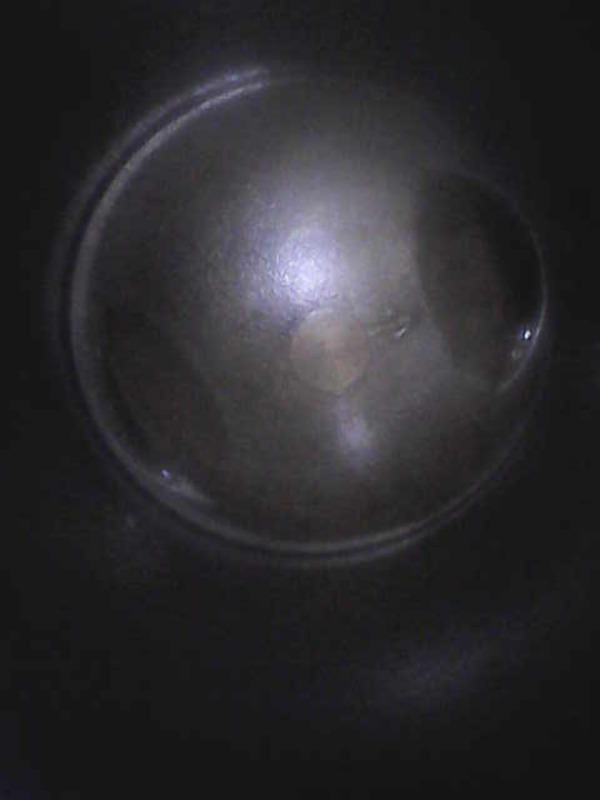

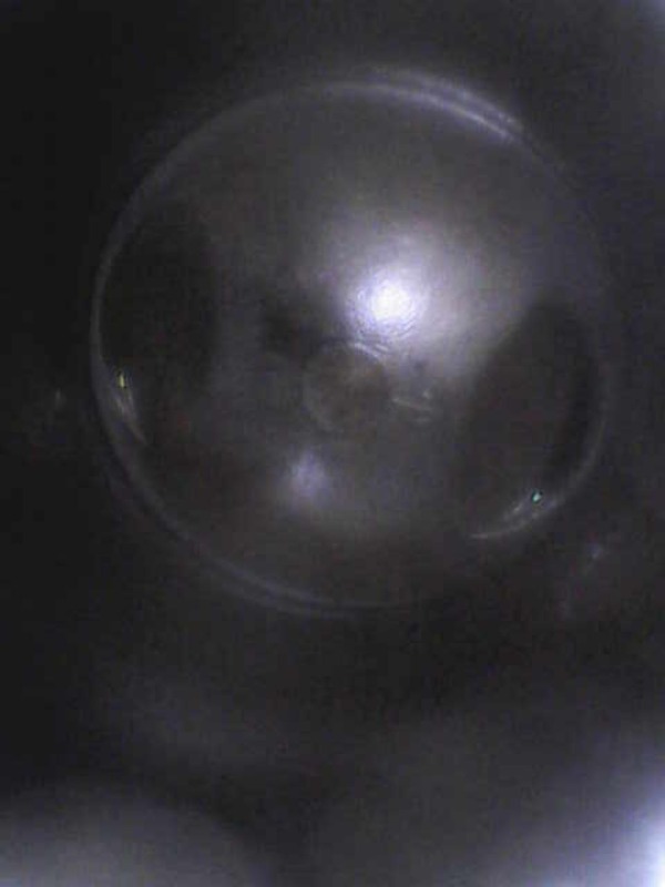

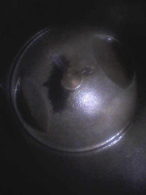

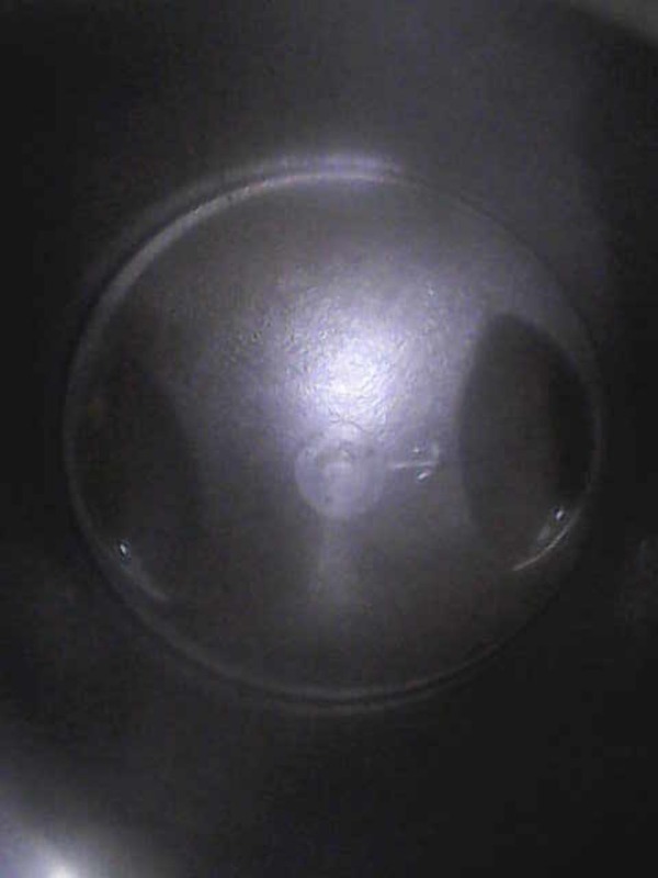

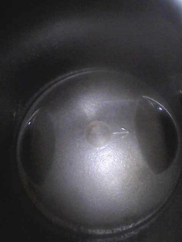

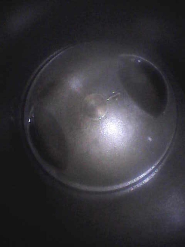

So since I have the endoscopic camera I have photographed the piston heads inside the cylinders.
The first photo is cylinder 1 and so on until 6.
