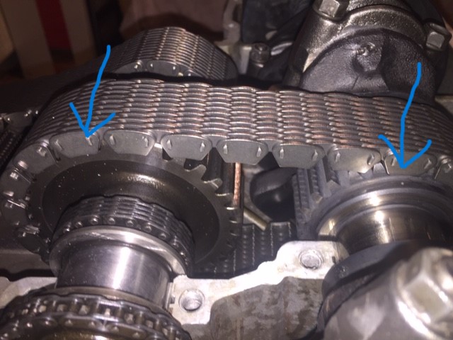

As for the timing mark on the crankshaft, I would suggest you get the secondary shaft in position and then count forward 7 full links and you should be able to see the mark on the crankshaft and confirm it. Then if necessary re-punch the mark or put a score line on the crankshaft so you know which tooth to use for alignment.

I counted seven links back from the mark on the output shaft and couldn't see the mark on the crankshaft.
This motor has already been disassembled, the two axles may not have been synchronized when it was assembled.
Starting from aligning the timing mark in "T" would it be possible to find out where the crankshaft mark is?

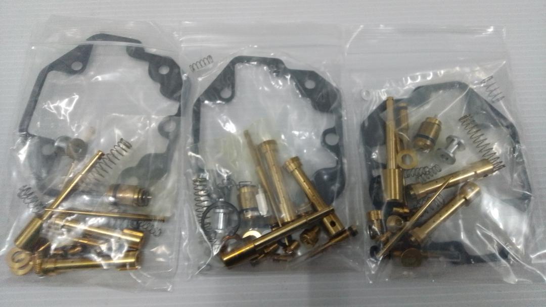

A month ago I ordered the Mikuni carburetor repair kit.
Today it arrived directly from Taiwan.
daminedingmoto.com/3-x-carburetor-carb-r...-kz1300-a1-a2-a3-b2/
We continue completing the puzzle.

I spent the night searching the forum for some clue on how to align the crankshaft with the primary shaft since I have only been able to find the mark of the primary shaft, I cannot find the mark of the crankshaft.
I found this photo in an old thread.
Can anyone confirm if those are the marks I should follow?
