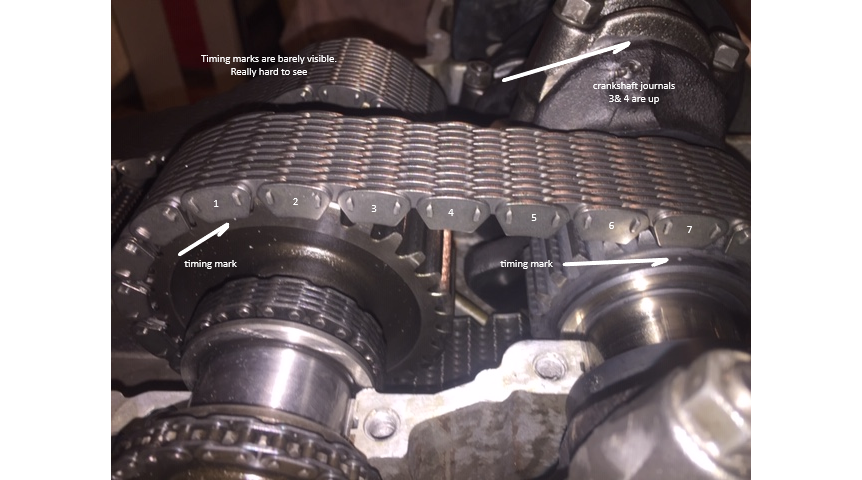

I also did a search for you and came across a post by McBoney
another basket case with a potentially different end goal
Icopied Paul's picture and added some text. Paul stated in his post that the timing marks are really hard to see.
Hope this helps
Hope this helps

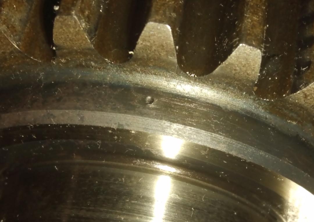

Kawboy's photo is the same one I used, thanks for the response.
I finally found the mark on the crankshaft.

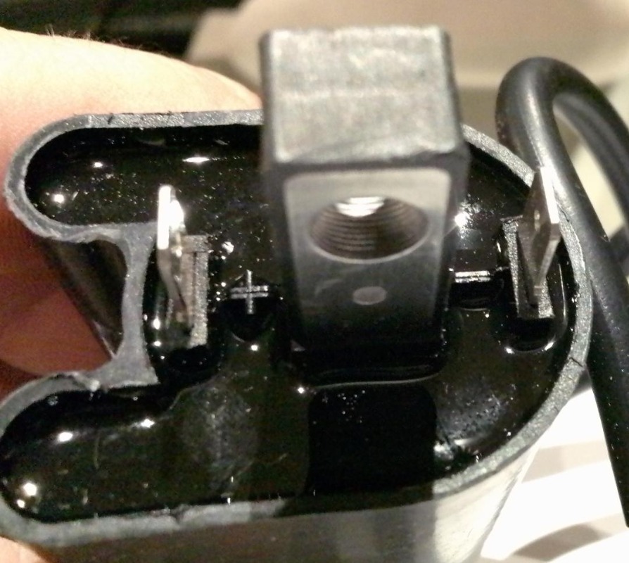

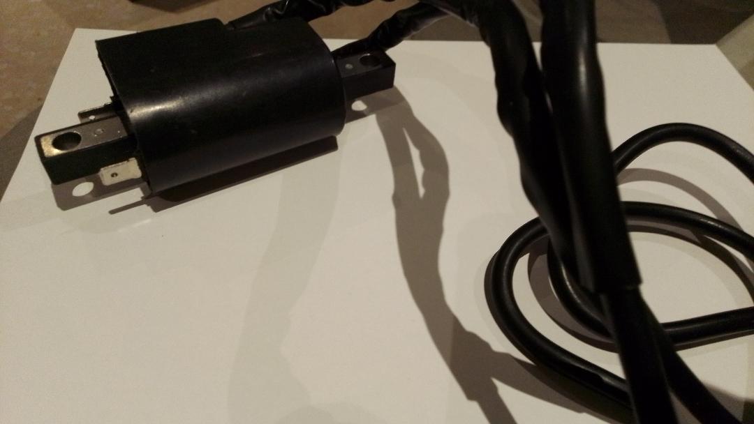

This afternoon I received the 3.5 ohm SQUARE coils to eliminate resistance.
My question is this.
The positive pole connected to the yellow wire that powered the resistor or to the blue/green/black wire?
The same question with the negative pole.

Yellow wire to the positive terminal.
Black, green, blue to the negative terminal
