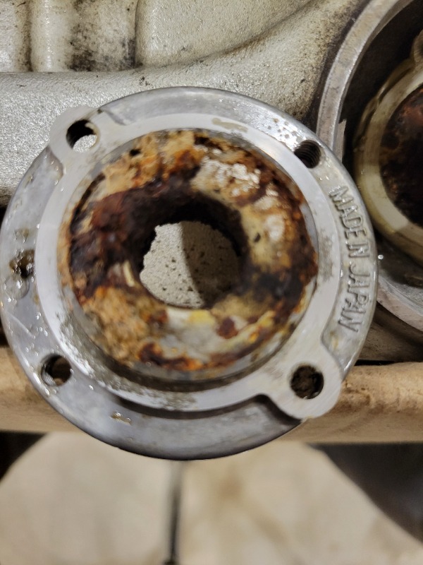

Bottom side of the mechanical seal housing

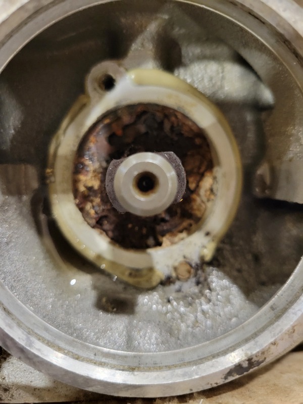

Cylinder head cavity where the seal housing mounts. Note the excess silicone sealant around the edges. Somebody (butcher) did a seal previously. So much crud, you can't see the lip seal under the crud.

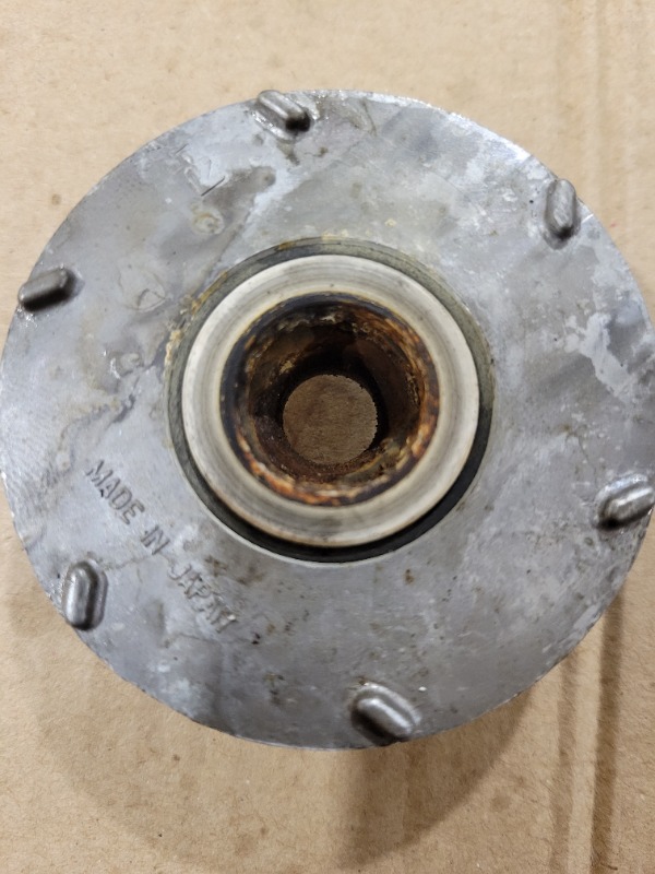

Back side the the stationary mechanical seal in the impeller. Note the crud buried in the impeller behind the ceramic seal.

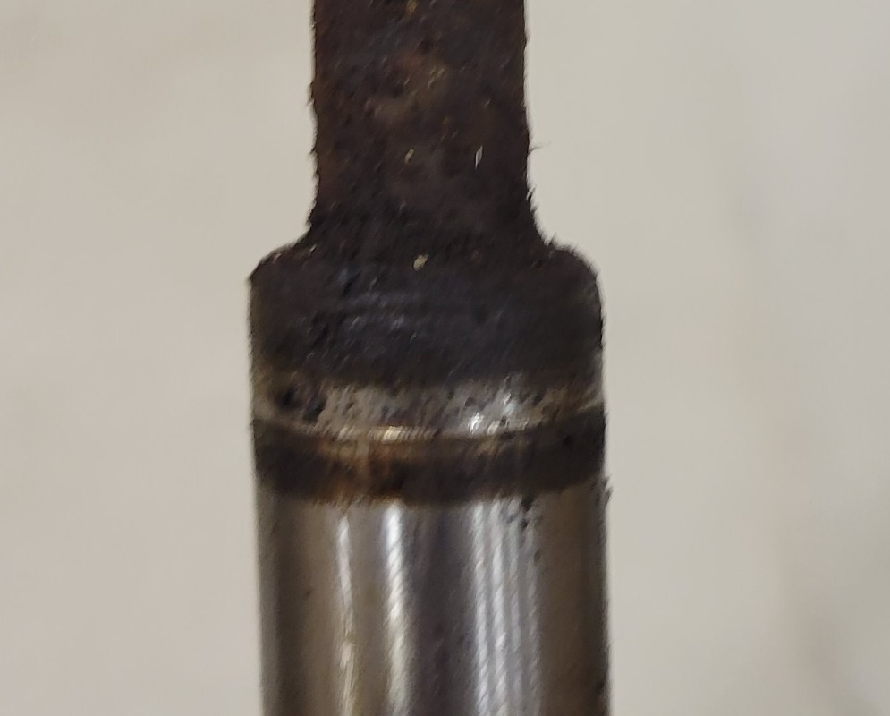

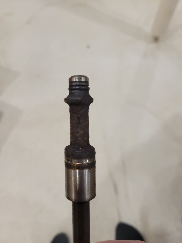

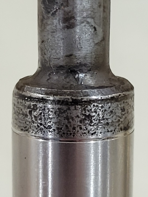

Water pump drive shaft. Pretty fuggly
Before cleaning
After cleaning up the shaft and paying attention to the area that the lip seal rides on with 1500 wet/dry paper and penetrating oil, this is what's left. Measuring the surface at the area I think the lip seal rides on, it measures .003" less than there area that the shaft journal measures. Not good, but maybe f I can find a shallow fitting lip seal, I may be able to get the lip of the seal to ride on a fresh area of the journal and not have to replace the shaft. We'll see.
The other repair option would be to brush plate the damaged area with copper, then machine grind to diameter and then brush plate with chrome. We used to repair shafts in the nuclear plant with this process. Pretty neat and you're left with a chromium surface for the lip seal to ride on.
Before cleaning

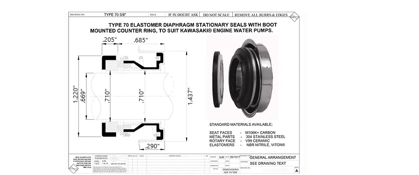

You would think finding a mechanical seal would be straight forward. I've used High-Tech seals in Newmarket Ontario many times before. Went to their warehouse today with parts in hand and as of 2019 when Covid hit, they closed up the doors and no longer offer counter assistance. You want help, send in the info and "we'll get back to you". Even when I called them from the parking lot and told them I was there, their only response was " You'll have to go to the manufacturer and get the stock part."
"It's a 43 year old motorcycle and parts are no longer available" I replied
"Try the internet" they said
I went to 5 different outlets including a pool supplier, an electrical motor rebuilder, a hydraulics repair shop, and an auto parts supplier. No luck yet.
I copied a drawing from the CMSNL site and added dimensions for the seal parts.

KB, I ordered and received a seal from Germany.. In my little hood could not find a 'spa replacement'.
FWIW, the seal fit into place.
Just today put coolant into system.. but no fire up yet.
Hopefully all is good.

At the time I went to a small family workshop that is dedicated to repairing all types of water pumps, in fact, they are the ones that repair the water pumps of all the agricultural machinery that I own.
When they saw the old seal they immediately identified it by taking measurements with the caliper.
He then brought a large box full of spare parts and loose parts and searching around found what I needed.
They don't have it in stock but they knew there were some lost in the warehouse.
That was my lucky day with this bike.

Measurements of Z1300.de seal and others here. Maybe of some
help
