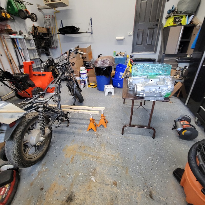

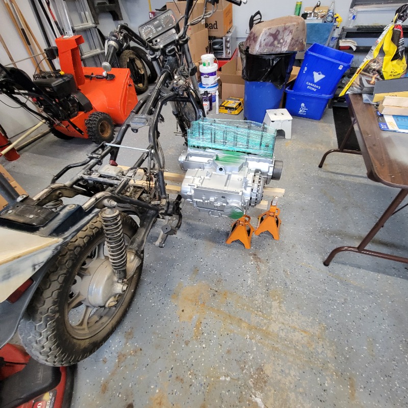

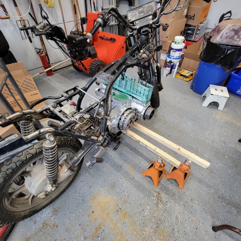

So, easy peasy - engine's on the table, 2 x 2 pine laying across the frame rails and set up on jack stands. Just lift the engine off the table ( Brute force and ignorance, or maybe better put, just pick it up and move it because , well, I'm only 69 years old and not dead yet) and place on the pine rails.
Engine sitting on the rails.
Slide engine into place, then lift the engine with a rachet strap and remove the rails. It took me all of 5 minutes to move the engine from the table and have in the frame hanging on the rachet strap. 15 minutes later, all the brackets are in place and all the engine mount bolts are installed. Just too easy and as slick as duck shit. Never worried about any possible damage. Safe and simple. Got to love it when a plan comes together.

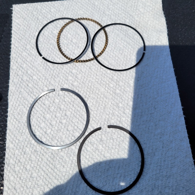

So we go shopping on EBay. Find a set of rings for the KZ650 - $36 USD. Send the seller a request for info and ask the ring thickness. Top and second ring 1.2mm, oil scraper ring 2.5mm. Hmmmm.
KZ1300 rings are top and second ring 1.0mm, oil scraper 2.5mm, so IF I were to open up the ring grooves .2mm ( .008") for the top and second ring, it would work. Also of note , the top ring is a chromium faced steel ring, the second ring is iron ( not sure if it's cast or malluable) and the oil scraper upper and lower rings are chromium faced steel rings. VERY INTERESTING !!

and each set of rings are sealed in a plastic bag. Laid out a set of rings for the pic. Looks very nice.
Looking forward to "fitting " the rings. I'll have to machine the grooves.
As a final note I goggled the MRKS6200 A designation on the package and they are apparently made by HUI YANG Precision in Taiwan. They have a PDF downloadable catalog and they make rings for Honda , Suzuki, Yamaha, Kawasaki and Vespa. Again interesting. Not sure where or how they retail at this point but would be worth looking into.
AND, damn, going through their PDF catalog, they also produce rings for , wait for it......the KZ1300 product # MRKS6200B DOH !!!! Now if I could find a retailer for the MRKS6200B rings, probably come in at $54 USD a set...... Bob's your Uncle. For now, I'll fit these rings since I have them and be happy.
