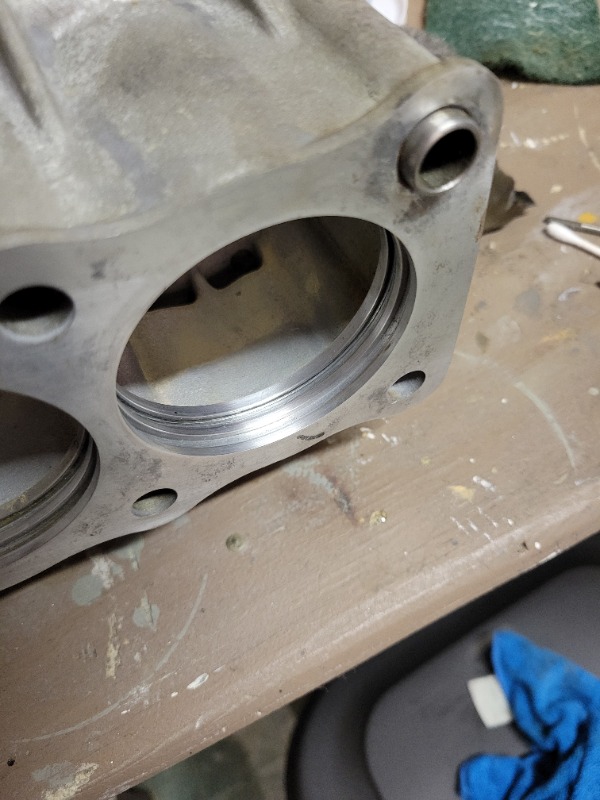

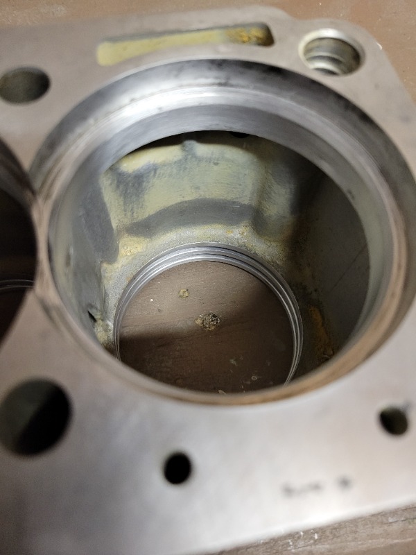

Still working on cleaning up the cylinder block for reinstalling the sleeves. I got about 8 hours into cleaning the block and I still have probably another 8 hours of cleaning left on the block, then on to finishing cleaning the sleeves.
I don't know what Kawasaki used to assemble the cylinder block and sleeves with, but it's baked on and no chemical will touch it. It's delicate scraping and then 400 wet / dry paper to finish cleaning. My fingers are just about wore out and cut from working inside of the 70mm bores of the block.
Bottom side of the block where 2 o rings belong.
Top land on the block where the top ring seals. Top o ring sits in a groove on the sleeve.

My arthritic hands wouldn't fit in there and if they did, wouldn't last for long. Take it slow and easy. But you know that.

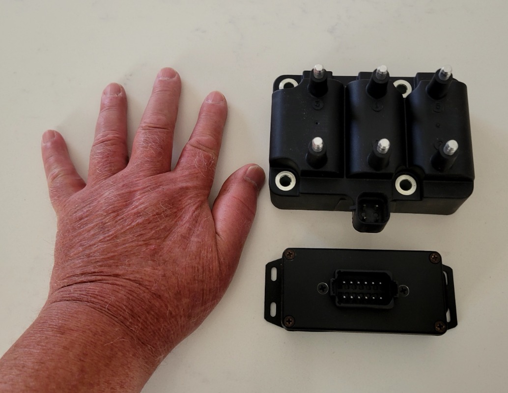

Just got the ignition coil and 4 channel ignitor from diyautotune for the ECU fuel injected aspect. This is to marry up with the Microsquirt ECU. All that's left to acquire is an ait temp sensor a crank trigger and figure out how to mount a 36-1 crank trigger wheel.

This is interesting. I'm really looking forward to seeing your ideas take shape! That's a neat coil pack - hopefully easy to find space for on the bike frame.
Regarding cleaning of the cylinder block, would Scotchbrite wheels of various grits, mounted on a rotary tool or a drill, make the job easier?

That is a beautifully compact "Coil-Block" ! Beats the crap outta dealing with 3 individuals and looks appreciably smaller then my GM coil.
