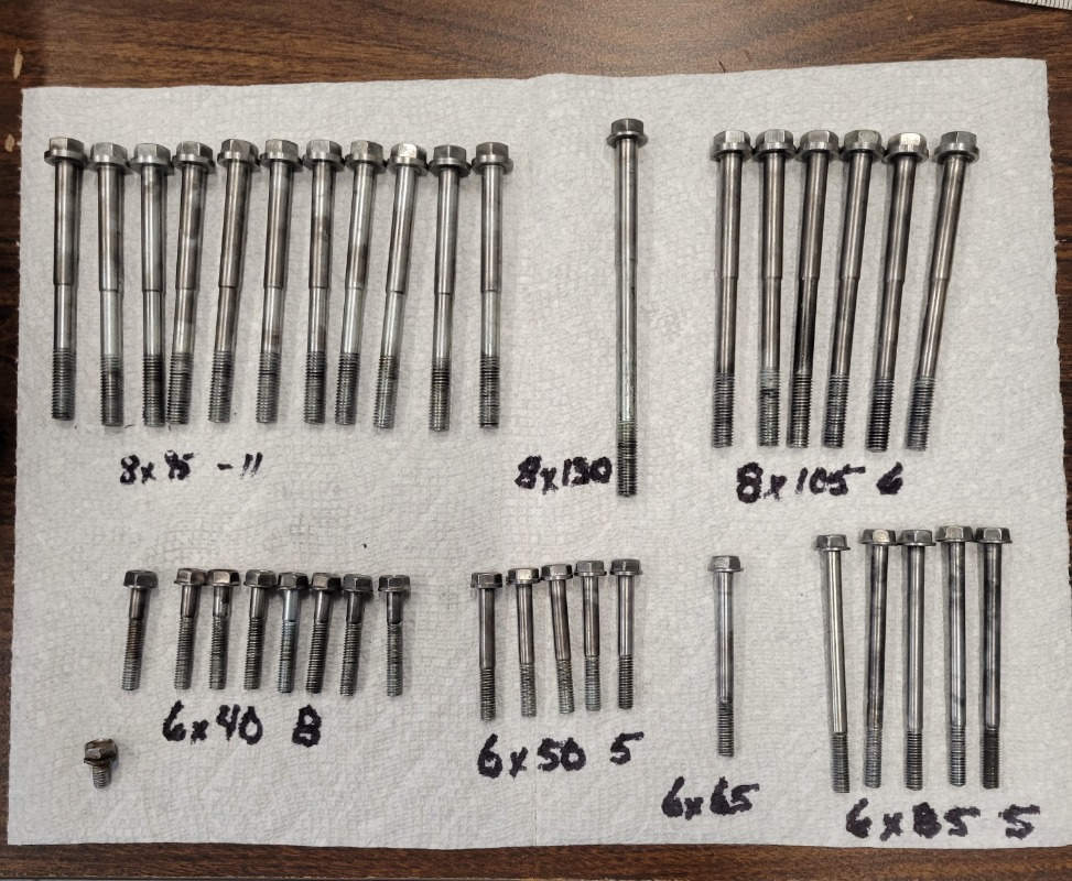

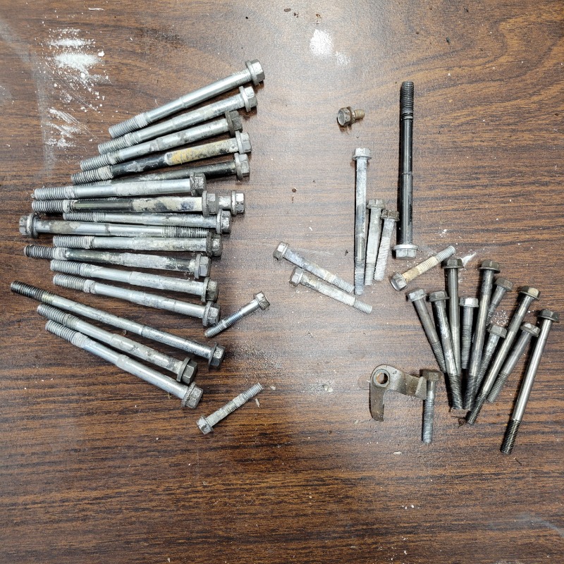

I've ordered a KLN110 cam chain and I'll shorten it to the required 72 links. There's a 3 week wait at the moment due to a back order at Kawasaki, so in the meantime, I have a pile of bolts to clean. What a mess. The case halves were joined with what looked like Permatex Form A Gasket (brownish in color and really thin), but the bolts are covered in what looks like a whitish sealant that I think is pipe dope. I'll wire wheel brush them on my 8" pedestal grinder and run a die nut up the threads and then decide if I'll treat them
Covered in what looks like pipe sealant. Too filthy to assemble with. So we clean.
3 hours later the lower crankcase half joint bolts are cleaned, and checked with a die nut.
