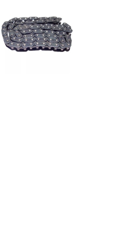

I was stuck for time today since I have an online meeting to attend at 3 pm. While I'm lounging around waiting for the meeting, I decided to open up the Service Manual and just see what's written about the timing chain. Well blow me down and call me Dusty - There is a spec for the stretch on the timing chain. 20 links not to exceed 128.9mm (page 191 in the Service Manual). So it would have been nice to know what a new chain would be but no, why would Kawasaki give you that info??
So, as I've said previously, the chain for all intense purposes measures out to be a #25 chain which has a .250" pitch x 20 links = 5" which = 127mm. So Kawasaki is allowing 1.8mm of stretch on a measured 20 links before replacement.
I went out to the shop and measured my timing chain at 128.3 mm so I'm .6 mm (.024") away from needing replacement. Good thing I decided to replace the chain. Bad thing I didn't check the frigging manual for a spec first. Why in Hell do we have Service Manuals for if we don't reference them??

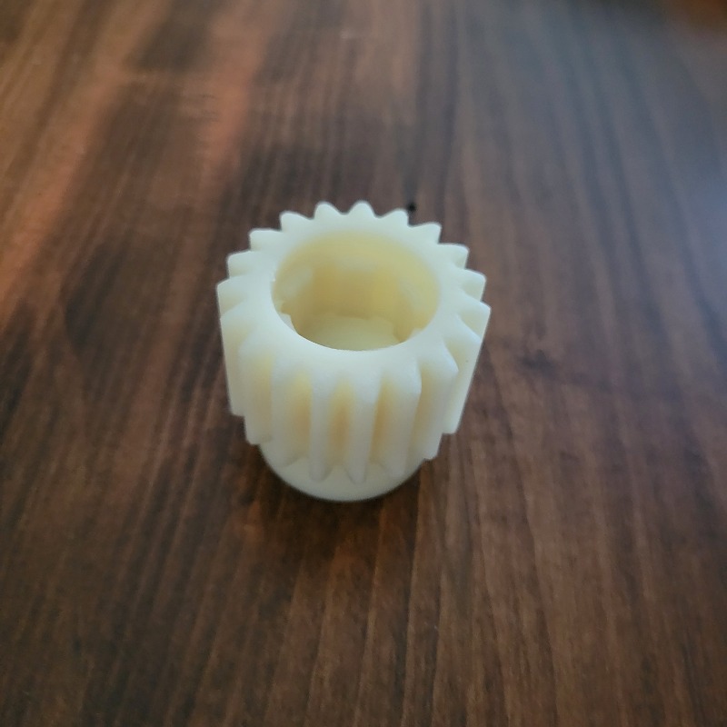

Christmas came early thanks to Helmut at
www.Z1300.de
. I recieved the new \Oil Pump Drive Gear. Looking forward to installing it.
I also think I found a source for the water pump drive chain. I've sent the seller a message to confirm the sizing of this chain.
