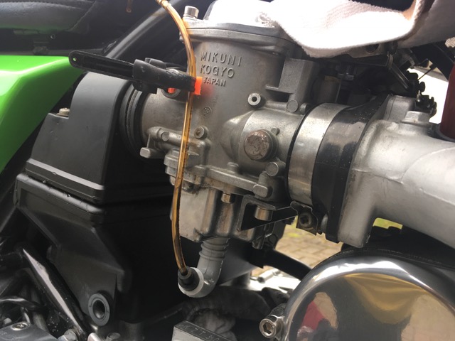

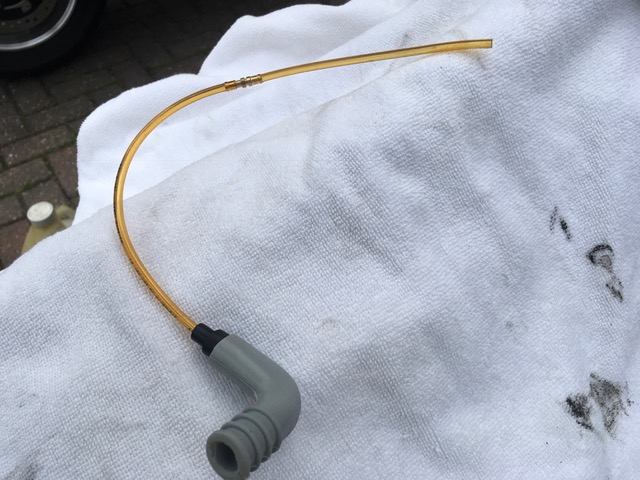

Hi, I have the same problem. These Zs simply do not start after a few days of non use, my US kz was exactly the same. The problem I have just solved concerned spitting through the carbs at just above idle. I suspected the float levels as the mixtures had been good enough before I changed the needles. I was glad to find the right hand carb fuel level was 3-4 mm low, this was indicated by whiteish plugs on numbers five and six. I have set all carbs to 7 mm from the mating face between the float bowl and carb body. The level checker is made from a nitro model exhaust deflector and some nitrile pipe. The float bowl has to be drained first and this fits perfectly over the drain plug mounting point.

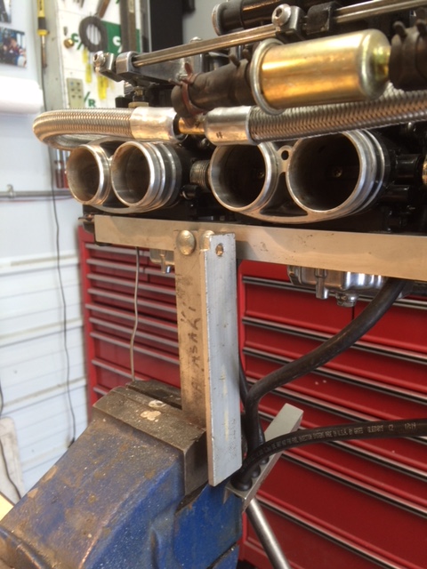

One question with float level tube method, when I checked mine I took carbs off made a wooden cradle so I could get level front to back & side to side ( even checked with little boat level -
) now I'm thinking on the bike the carbs are not level does this matter with my check??

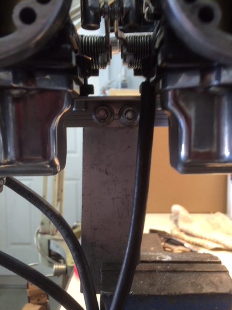

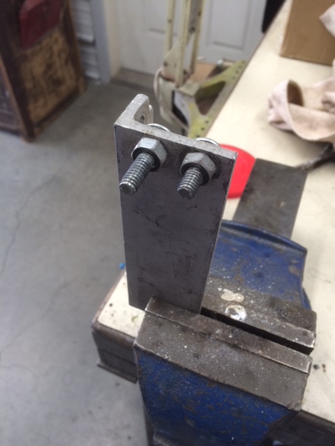

Regarding setting the float-level and "how level do they need to be?"
YES, the carbs when mounted are at (about) a 5 degree tilt DOWN towards the engine. NOT an issue ! A "Leveling Cradle" is a good idea. Any manner of holding the carb(s) steady and level on the bench is a necessity ! I have two methods for doing this depending on whether I'm adjusting the float levels with the carbs as a complete set or individually. This is how I hold a "set". The Carb-mount needs matching two holes.
