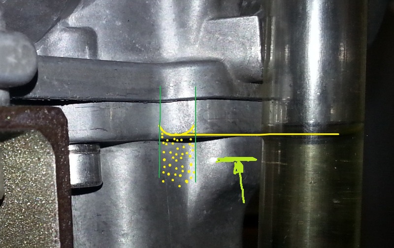

6.5 - 8.5 mm below the "lip" as indicated by the green line and arrow. NOT the mating surface or the fuel level will be high.

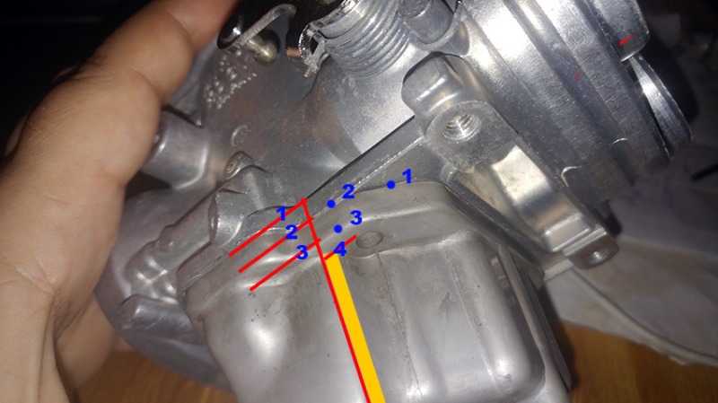

I can't delete the other message, so I will post another one to clarify once and for all. At least in my head!
Number 1 is for where the top and the bowl actually seal (mate?).
Number 2 is where the they appear to 'mate' from the outside
Number 3 is the lower edge of the thick bowl's mating surface.
Number 4 - fuel level.
My confusion is mainly between 1 and 2.
So, the 6.5 - 8.5 mm should be measured between 1 - 4 or 2 - 4?

Now I understand Stan. I set floats @ 7.5 - That's the green arrow/line . An easy reference is to note that 7.5 is in the middle of that bowl contour that is below the flange. By your photo, your level would appear to be high but it could be 6.5. I can't judge due to the angle. So you'll be measuring from #4 -6.5 and DOWN. The manual shows a drawing depicting the fuel level relative to the side of the bowl.
