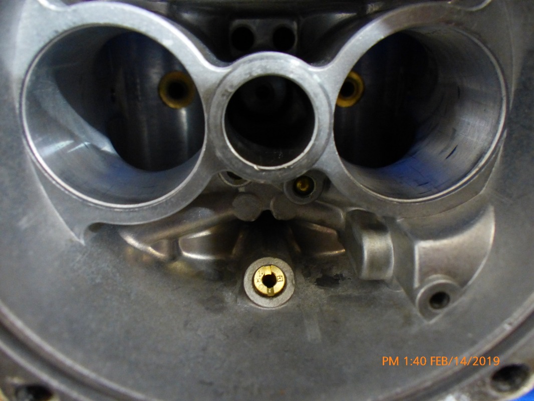

7 years 3 months agoStrangely these jets are not available in the UK in that size so ordered from the good old US of A. Looking forward to trying this modKawboy wrote: This is a repeat of what I posted in "Kawboy's Restoration of a B2"
Popped the lid of of the carbs and started the mod. The thread size on the B42/55 is a 6mm x 1mm standard thread. The tap drill for that thread is a #9 which is .194" I measured the bore of the air jet in the body of the carb at .191" so there was no reason to have to run the #9 bit in the hole, just tap it out to 6mm X 1mm. Tapped it in 5 threads, cleaned the hole with a vacuum and pulled the choke plunger out to ensure no aluminum thread filings. Inserted the jet and Bob's your Uncle. So I've choked down the air to the choke circuit from .191" to .110" using the B42/55 X #280 jet.
I also like the nice clean look. If I decide down the road to change the orifice size, the B42/55's are available in #70 (which is .7 mm) to #290 (which is 2.9 mm)

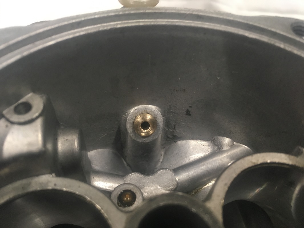

Read through all the posts on this and after the bike repeatedly failed to start after a few days I decided this modification was a priority.
Whipped the carbs out, took about 30 minutes - that's about 6 hours less than it takes to do the CBX ones:(

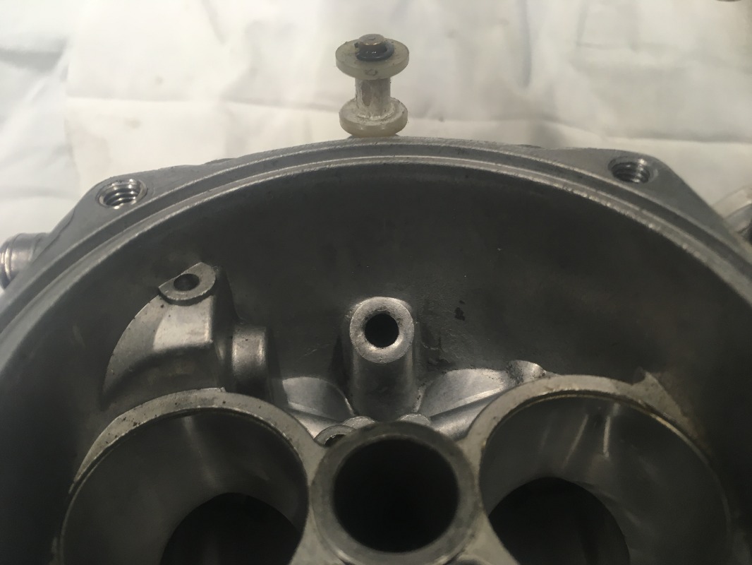

Took the tops off and found the take off
Measured the hole size in the casting and they were between 5.06mm and 5.11mm.
I know some have tapped the holes and used jets etc and they have the advantage of being removable but I didn't really want to tap a thread into the carbs because of the swarf from the tap, I know that it can be cleaned out but didn't have to take the chance of contamination.

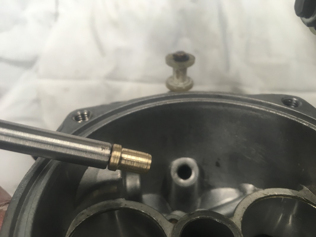

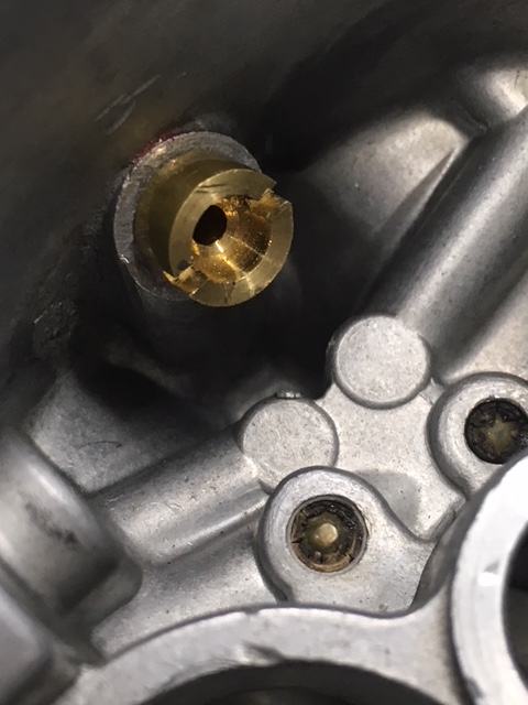

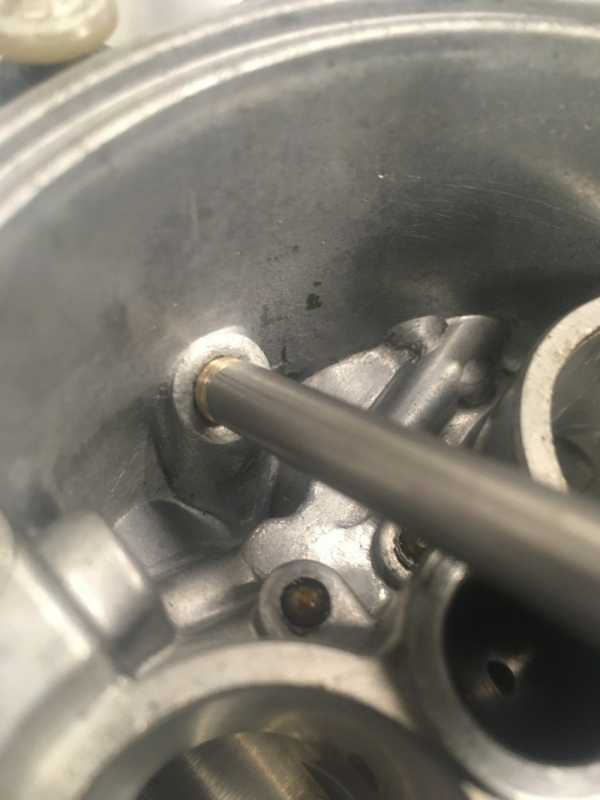

Turned up some brass top hat bushes with a couple of thou' interference fit on each hole and a 2.5mm hole through the center. These also had a taper lead on the end, also made a small drift for installation purposes.
Tapped each bush into the hole, nice fit and they stop against the turned shoulder.
And the fitted bush.....
Put the carbs back together and back into the bike.
Turned the fuel on and took about 10 to 15 seconds cranking to fire up on first start.
The big difference is after a week or more of the bike being laid up I can turn fuel on, apply choke and the bike will fire up within a second, it really is night and day - fantastic fix.
