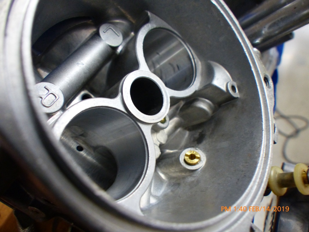

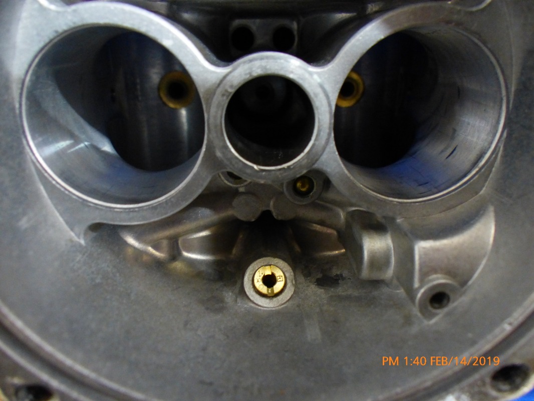

This is a repeat of what I posted in "Kawboy's Restoration of a B2"
Popped the lid of of the carbs and started the mod. The thread size on the B42/55 is a 6mm x 1mm standard thread. The tap drill for that thread is a #9 which is .194" I measured the bore of the air jet in the body of the carb at .191" so there was no reason to have to run the #9 bit in the hole, just tap it out to 6mm X 1mm. Tapped it in 5 threads, cleaned the hole with a vacuum and pulled the choke plunger out to ensure no aluminum thread filings. Inserted the jet and Bob's your Uncle. So I've choked down the air to the choke circuit from .191" to .110" using the B42/55 X #280 jet.
I also like the nice clean look. If I decide down the road to change the orifice size, the B42/55's are available in #70 (which is .7 mm) to #290 (which is 2.9 mm)
