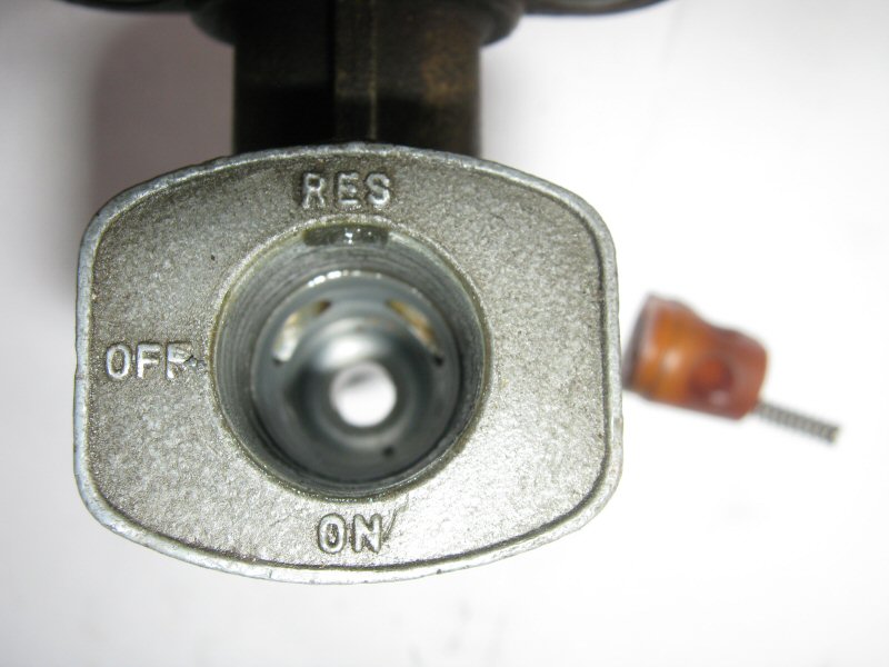

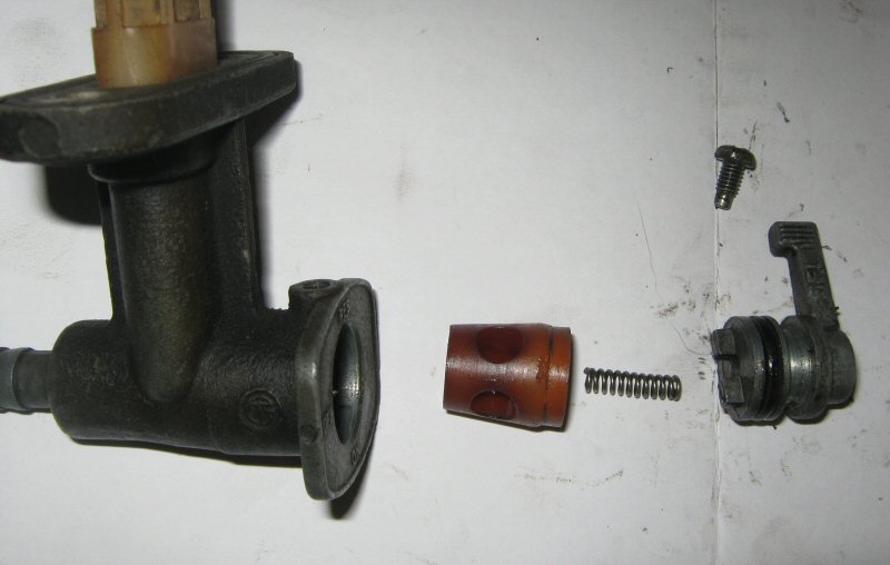

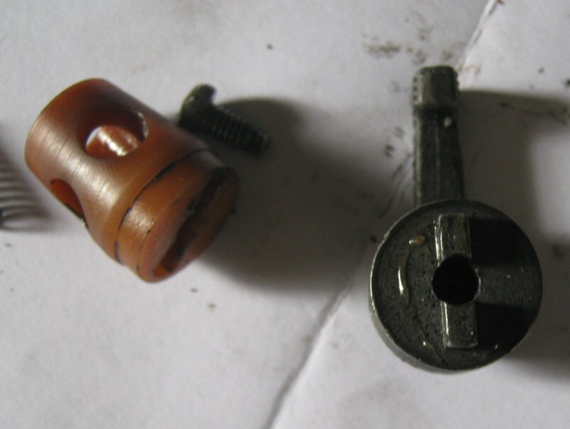

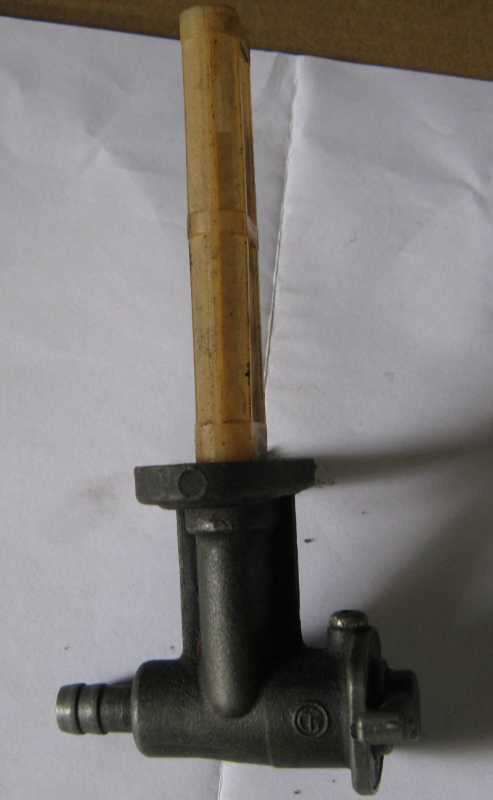

Also sometimes the screw that holds the selection lever in sometimes bottoms out and binds on the body of the lever, a small flat washer gives a little bit of clearance, hope you don't mind if I throw a few photos in so new people know what the inside of one looks like ??, I am not trying to hi-jack your thread, apologies if I overstep the mark ...

Good pictures of the fuel valve ! Two types on the carb'd version. I believe the one pictured is a '79. The 80's and up used a separate chrome face-plate and it's two screws to retain the cone assembly.
A good point regarding the style pictured. The single retaining screw could cause some interference so adding a "shim" washer would alleviate that concern. The "tab" on the back of the selector lever is what requires it's height to be reduced to avoid "crushing" the cone into the bore, which is why the valve is difficult to turn and becomes very difficult when things heat up.
With the height of the engaging tabs reduced the spring shown can now do the job intended of applying an inward pressure to maintain a consistent tight fit of the nylon cone to the tapered bore. If the cone or bore are (lightly) scratched the two can be "lapped" together using a light abrasive compound. I used a slotted screw-driver head in a cordless drill to spin the cone. The success of this will depend on how badly the two pieces are scored. Scratches (gouges) that are too deep will require the valve be replaced as the valve will leak when shut off. The scratches/gouging of the cone and or bore will result from the in-tank filter being removed and (typically) rust and other debris making it into the valve assembly.
