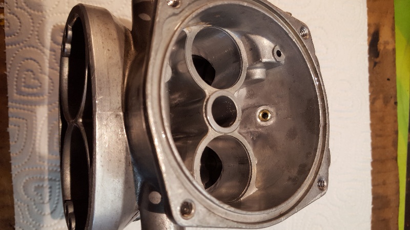

Can you please confirm if the gasket is ok to cover the original Air Feed Hole from the venturi to the diaphram chamber (blocking it off) or does the gasket need to go around that orifice to allow it to be left open ? Photos of the cover and orifice attached

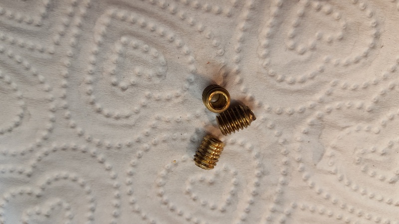

I opted to use M6x8mm Brass Grub Screws with a 3mm hole thru the centre as my "restrictor jets" for the Choke Air Mod as seen below.
After using an M6 x 1 Tap in the existing choke air holes, I screwed each "restrictor jet" into them with just a dab of blue thread lock.
These fit very well and look the part !

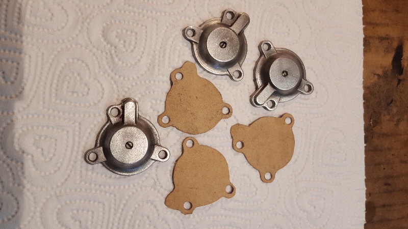

Next I made gaskets for each of the of the 3 Enricher Circuit Diaphram Covers and fitted them without the Diaphram and Spring.

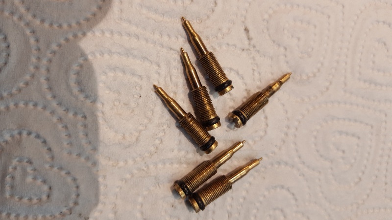

On to the 6 x Primary Circuit Mixture Screws. I used a sheet of 2000 grit Wet & Dry Paper to carefully reduce the length of the end needles and re-profile them as Scotch recommends. This is probably the most inticate part of all the mods, so I used a good magnifying glass to ensure all was good. I think these will make a big difference to the whole set up of the primary circuit and make it much easier to work with.
